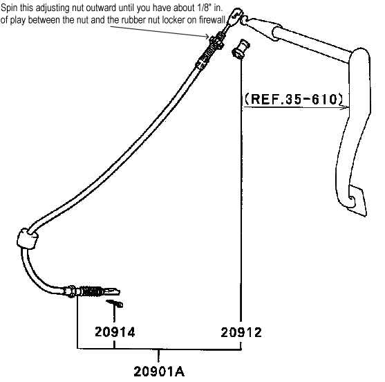

    Clutch is going out but can't afford to buy a new one yet. How do I tighten the cable clutch? It was done once before but cannot remember how to readjust it.
    If it's the cable type, open the hood and against the firewall grab the clutch cable and pull it away from the cab like your going to pull it out. Spin the adjusting nut so there is about 1/8 in of play between the nut and the rubber nut locker on firewall.
    See below

    Last night the clutch cable snapped. How do I reinstall a new one? I need a diagram or instructions. Some piece snapped inside the firewall and my clutch went limp.
    04-04-2011
    712
    Columbus, OH
    1992 Mitsubishi Mighty Max
    link to manual on his site http://www.mightyram50.net/d-50/Fact...-1983-1993.zip
    Section 8 deals with the clutch, pages 8-4 & 8-5 the cable replacement. even has pictures...
    get the part from a Mitsubishi dealer when the Dodge dealer says he doesn't have one.
    Good luck
