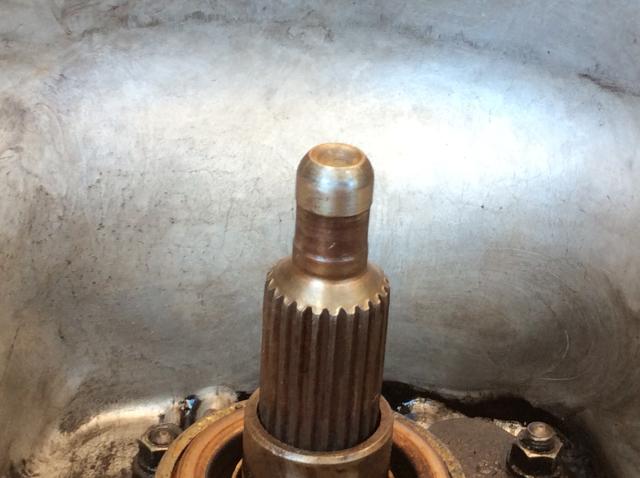

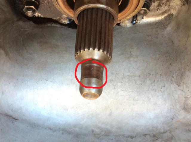

    Also, when you find a trans, examine the input shaft. It should not have any groove in it.
    If there is a groove as in the photo above, I'd avoid getting that trans. The ~ 5/8" wide groove in the photo was caused by a seized pilot bearing. Because of the groove, the front of the input shaft isn't adequately supported by the flywheel pilot bearing which puts stress on the input bearing and other parts within the transmission. Not good.
