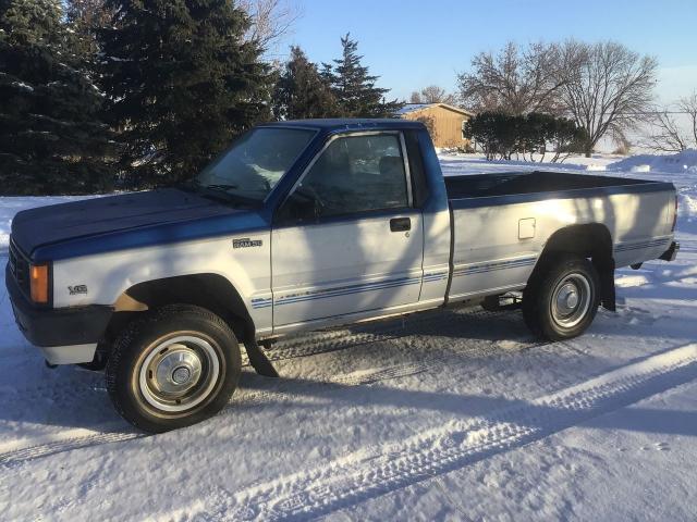

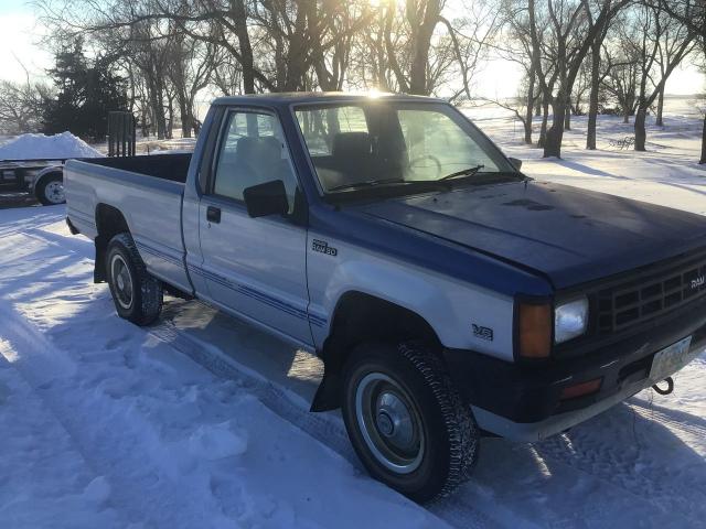

    Picked up another D50 today neighbor bought it but gave up on getting it to run it has computer issues. He thought it was a 1990 but it was a 91 V6 4X4 A/T it’s in really good shape. I have a bunch of body parts so that works just need to get it running it’s the first V6 I’ve messed with. Paid $1,250 so not a big investment if I get it running I’m golden if not a have rebuilt 2.6 I can drop in it.
