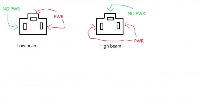

    So, I got some LED headlights that were from amazon, but I only paid $7 for them. Using a power supply, they do work as they are supposed to. 1 ground, 1 power for low and 1 for high. Problem comes from the truck side. Using a test light, this is what I get:
    Not sure how that could be translated to run these lights. It's a 1st gen truck, btw.

    I infer you were just connecting the test light terminals across pairs of connector terminals to get those results?
    The better approach to distinguish the hot wire from ground is to connect one terminal of the test light (the alligator clip, if it has one) to a known ground, then touch the other terminal probe to each of the connector terminals to determine which one is getting power with the switch in each position. To confirm which one is the ground, connect the clip to the battery (+) then touch the probe to your probable-ground terminal in the connector, which should then light it up.
    Anyway, your diagram does look typical for a 5x7" rectangular combo-beam (H6054 type) where, looking at the connector end, the right terminal is a ground, the top terminal gets +12VDC when the low-beams are on, and the left terminal gets +12VDC when the high-beams are on.

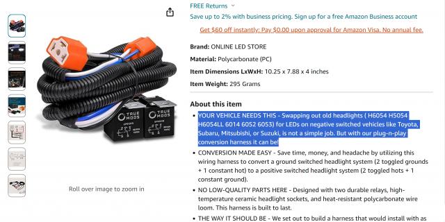

    So, Toyota wired their headlights to switch grounds instead of power. Maybe I'll try the relay scheme for Toyota and see how that works.
    According to this information, that is what I have to do. We will see...

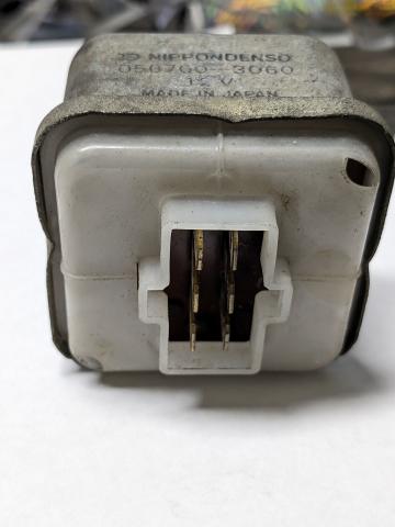

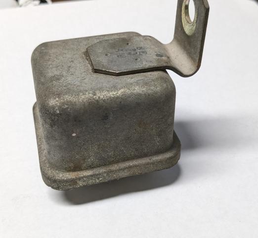

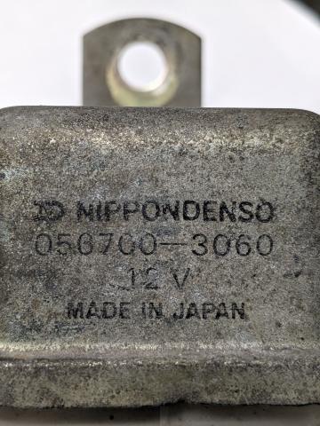

    This thing is in the headlight wiring, what is it? I assume it's a relay for the park lamps, headlights and high beams. I cannot find this thing anywhere, and the part number printed on it brings zero results.

    Google 056700-3060 and a couple sites call it a light control relay with the Mitsu P/N of MB046436. Appears to be available but pricey. Have you removed the metal cover? With it off you should be able to assess the condition of the coil and contacts.

    Wow, that's quite the price for what is basically 2 relays.
