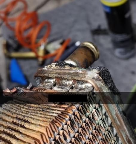

    I had the same problem as you, except mine got so bad that coolant started seeping out of the heater assembly.
    Getting the heater core out wasn't a terrible task, the worst part of it was removing the hoses as they were stuck there pretty good. Use your hands and twist them while you pull the hose off. Do not use a pipe wrench like I did at first, ended up tearing a hole in the hose and slightly bending the pipe. It was all fixable afterwards though.
    I located the leak to some crusty old solder joints, luckily they were on the outside part of the tubes.
    Cleaned them up with a brass brush and some brake cleaner, and soldered them with a tiny butane torch and regular solder.
    It was not easy, and it doesn't look good, but it helped.
    I can see by inspecting the heater core while the car is running with full heater and fan turned off that there is a slight amount of sweating still. At least it was better than it was originally, and is a placeholder until I can find a better (or hopefully a new) unit to replace it with. Alternative would be to remove my three leaking tubes and seal those completely, but I bet there are other bad solder joints too.

    Update: I have yet to find any heater core replacement, and my core leaks worse than ever before now. Last resort is removing it and doing a bypass, driving in the freezing cold in winter with the windows down.
    I had my hopes up when I ordered one from mitsubishidirectparts, but they cancelled it afterwards and sent an e-mail that it's discontinued and out of stock. There are none of these left on the wreckers in Norway, so I need to keep searching abroad.
    Hit me up if anyone here knows about a heater core available (MB123852).

    I got a radiator shop to make me a new heater core, it wasn't cheap at $450, but it was the only choice. Now it will most likely last another 30 years so I'm happy. Got some new hoses while I was at it too and changed out some foam seals that had turned to dust.
