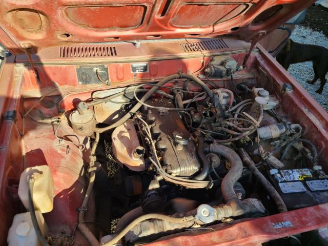

    Well, its been about 2 years since I had the idea to pick up one of these trucks. I wasn't especially serious about it for a while but my older brother sent me a Facebook link last Friday and I ended up picking this up Saturday. 1979 D50 88k miles, $600. Its now holding down gravel on my side yard
    It idles but apparently the carb is bound because it won't accept any throttle. Its got some rust (I wouldn't say terrible but I suppose I'm no expert) and the interior is in a bit of a mess.
    My goal is a restoration back to stock. Not quite sure how deep I want to go with it so I'm trying to figure that out. I'm thinking that I will start making a list of everything that I can tell is wrong and prioritize the repair schedule. I think I need to get that carb sorted out so I can drive it and see what else needs to be added to the fix it list.
    Any suggestions or tips on things to consider would be appreciated.

    Here is a good newbie question...how do I determine what OEM hardware is on the truck? I have attempted to decode the VIN but that hasn't worked. Any help would be much appreciated!
    1,556
    MFGs nameplate on the firewall gives engine type ~ driver door jams give tire/wheel info

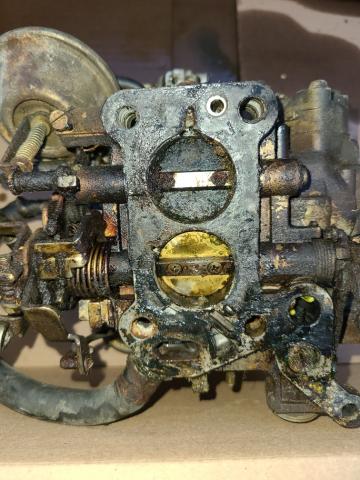

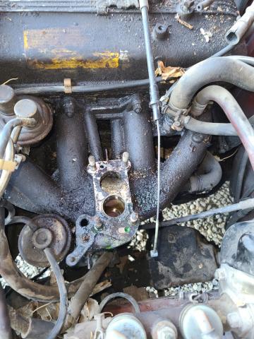

    Opened the hood yesterday at the behest of my 8yr old son.

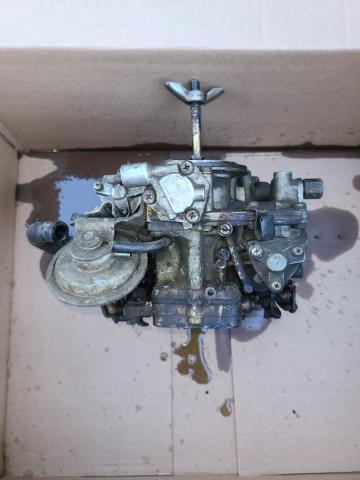

    So, we pulled off the carb.
    I'm amazed with the level of buildup on the throttle blades, the prior no-response from the pedal makes a lot of sense after seeing this!

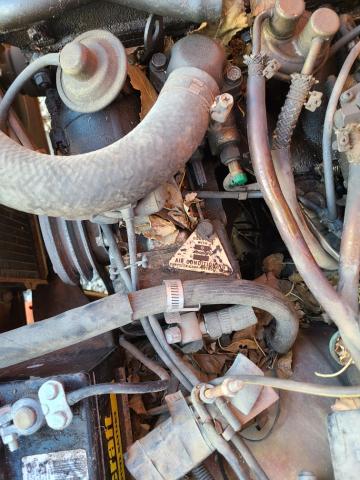

    I was expecting to remove an electrical connector from the carb, however there were none? More vacuum lines than you can shake a stick at though.
    I also was a little surprised to find this AC tag, as AC is not described on the dash. Ideas on why this is there?
    The plan right now is to get it to run on the cheap to further identify all problems and determine best path forward. So I am going to clean and rebuild carb.
    Questions:
    1. My research so far is indicating that this is Mikuni Solex 30-32 DIDTA carb. Confirmation?
    2. Any recommendation on cheapest but most useful rebuild kit? I've seen some as low as $20, however I'm not confident it will get it done.
    3. I have perused the weber carb swap articles here. I'm not ready to invest in that yet, but is it worth it? Ballpark cost?
    4. I'm planning on Berryman chem dip to work on the carb, followed up with aerosol cleaner - unless there is a better suggestion?
    Thank you in advance!
    1,556
    Wow Eric hose city under that 79 hood..!
    I went the ultrasonic cleaner route from Amazon and then used what I had on hand to clean the carb (Pine Sol dulled the metal ~ dish wash soap in the ultrasonic cleaner was better) Orange flavored mild non caustic paint remover worked pretty well to remove old gasket material & carbon (let it soak overnight & do the process twice or more)
    A/C was installed on the USA pier or at dealerships is what I been told ~ maybe the A/C system in your truck was not entirely completed for the original owner OR MAYBE a previous owner removed some parts or maybe scavangers took stuff?
    Wishing you the best ~ any gasket kit should be ok BUT if the store has some on hand ask the clerks to allow you to open the kit boxes to judge which brand you like best (kit don't haffta be for your carb ~ inspect the brand quality)
    Have Fun & Hug the Kid
    George ;^)
    1,556
    Eric
    If Utah has no SMOG tests or inspections then a future Weber conversion has good potential in that hose rats nest... It would be very wise to remove and inspect a catalytic converter IF your truck has it & ensure the muffler exhaust system is clear 'n not causing too much Back Pressure.
