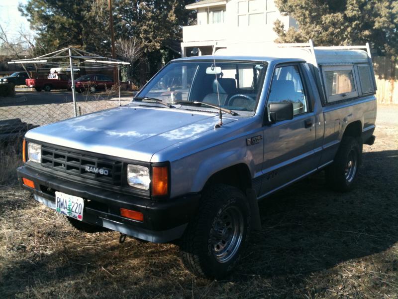

    Well I just bought an '87 Power Ram this morning, first time owning one of these but I had looked into them before getting my last truck. Someone right around the corner from me had it for sale, and it was right in my price range.

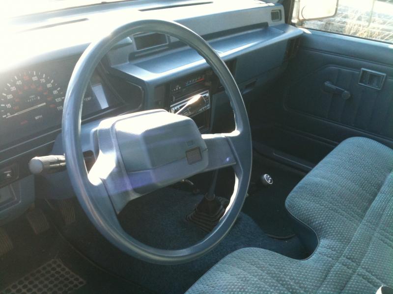

    I'm impressed with it so far. Runs good, very clean interior, 4x4 works. I haven't done a lot of work on trucks or engines before, but am wondering what general maintenance might need to be done. It has 144k miles on it, has had the timing chain replaced but he wasn't sure at how many miles (he had only owned the truck for 4 months).
    I don't have any special tools or a shop, but am getting a Haynes or Chilton's manual today. The EGR valve was taken out, apparently done properly and all vacuum hoses were capped. It takes awhile to warm up when it is cold out, and apparently is an issue with the choke? I have never owned a carbed engine or worked on one, but that's what the previous owner said.

    Welcome to the site. Clean truck... If you look in the manual section you will find we have darn near every manual you can think of. If you look through the WIKI under history then you will find information to learn what you have under the hood and cab. The more you know about these trucks, the better. You will find that the more you learn the easier they are to locate parts and repair. #1 change the oil. In everything. Differentials, engine, trany, transfer case, power steering oil, and brake fluid. If the coolant is not nice and green change it also. I would bet you $5 that some have never been touched. The more you show the truck love the better it will run. OH and don't forget the fuel filter.

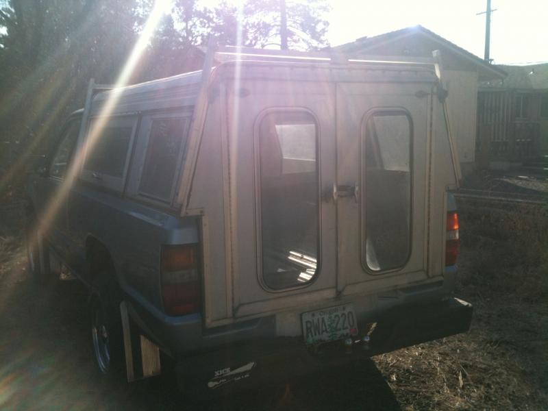

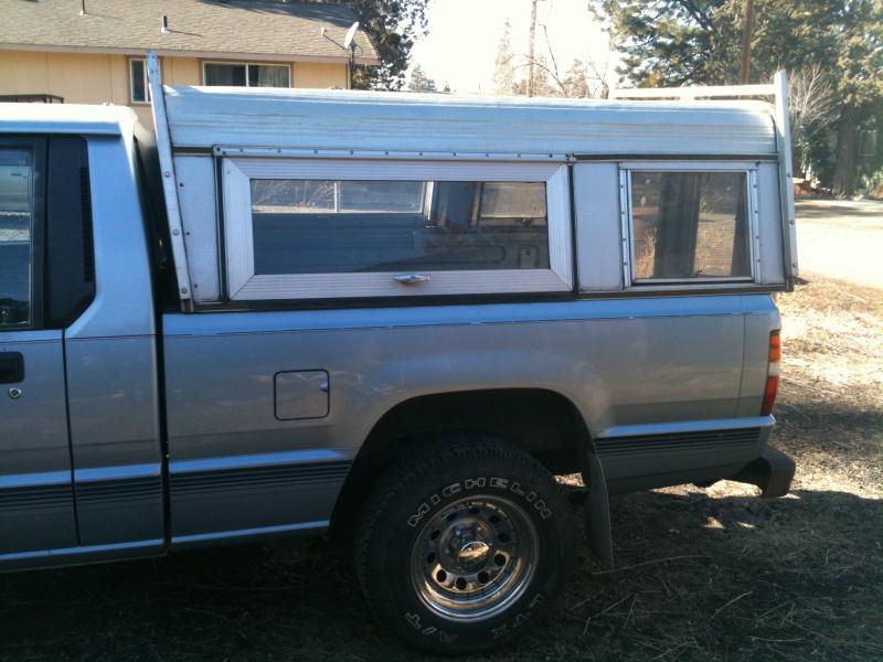

    What is type of shell is on the back, i would like to get one for my 1984 Toyota pickup, but I'm not sure what type it is.

    Oh and I have no idea about the camper shell, looked everywhere and can't find any logos, tags, anything. Seems like it fits good other than there being a rubber gasket around the cab window area, so it doesn't slide all the way against the truck. PO said I could cut the plastic gasket off and it'd slide all the way up but I want to be sure before doing anything like that.

    Power steering fluid is hydraulic fluid ISO #46, ATF type F has a micro grit in it. ATF when used in things like a floor jack will harden the "O" Rings. But in a power steering operation in fleets like Coca Cola we just used ATF. Except in the Semi Trucks. you use engine oil. Normally it's printed on the cap of the reservoir or on the dip stick what to use.
    The Canopy is a "tradesman" or Commercial style. not sure who still makes them but someone should.
