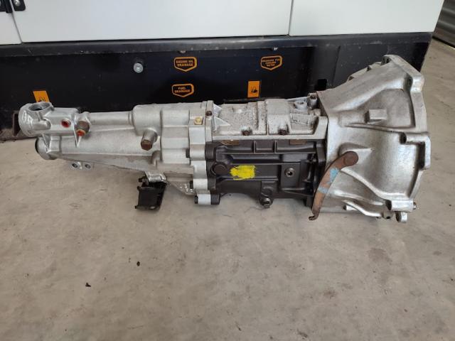

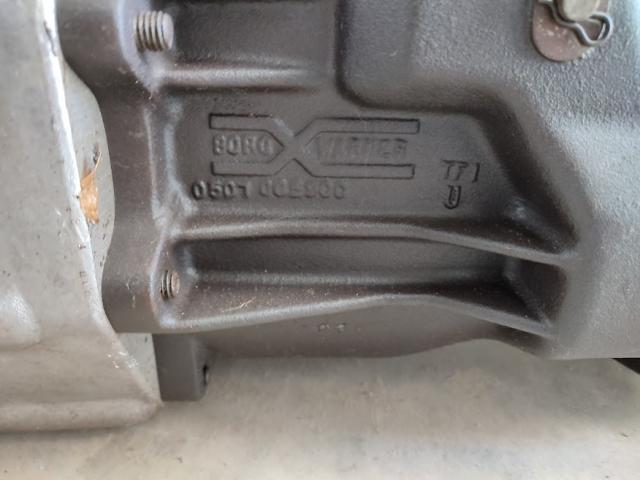

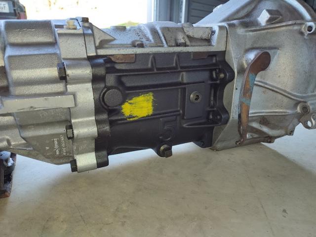

    Is there a id tag on the T5 ?
    If so could you post a pic ?
    Thanks!
    T5...... 5 speed gearbox? I think this transmition was from our local Sigma cars. Narrow block 2lt engine. though from what I can work out it was only offered for a short period and most Used the Jap 5 speed. Aparenty the Jap box is a better choice as the borgwarner isn't the strongest box. Though the same gearbox was offered in some 3lt 6cyl fords and a few other local cars of the time. Though I will give it a go and see how it hold up.
    It'll hold up. They were used in the GH factory Sigma turbos. The KM135/145 are more desirable transmissions. I have a feeling the the Japanese transmissions are lighter too (may be a part of the preference over the BW...)
