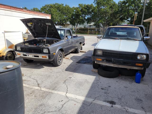

    1,588
    Nice truck !!
    Does it have cruise control ? Drivers inner fender has a large round diaphram actuator looking piece?
    Good luck tuning the carb.
    Welcome here too

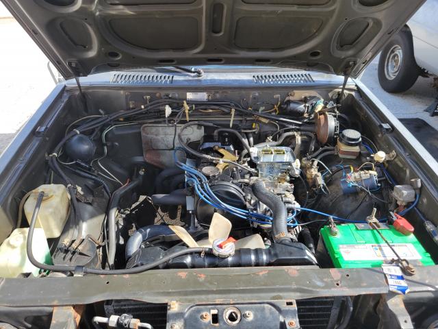

    She does have an aftermarket cruise control in her, it stopped working but when I was working on it I found one of the wires to the pickup on the speedo cable was split so I soldered that back together. The guy who put it in put it right above the valve cover and I have yet to put it back there which is why it is sitting up by the brake booster currently mostly unhooked.
