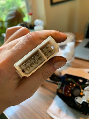

    gen1 plug style (mines a 86 which seems to be a cusp year?)

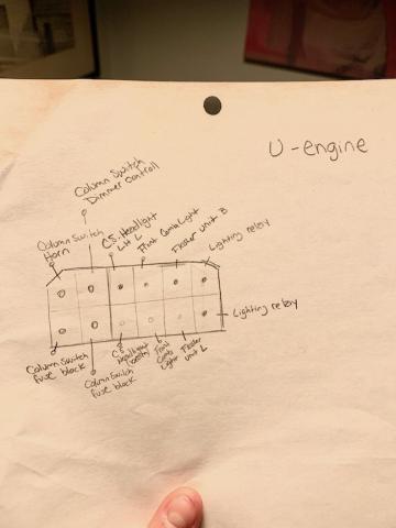

    here's the diagram i compiled from my manual:

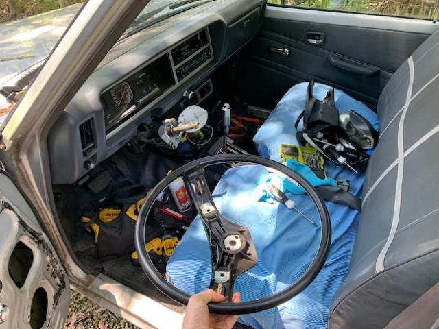

    here's it all apart:

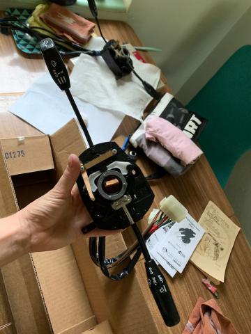

    here's the new switch fresh out of the box:

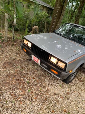

    and my lights working as they're supposed to!
    Awesome! Any plans for a headlight upgrade now the switch assembly is doing it's thing?
