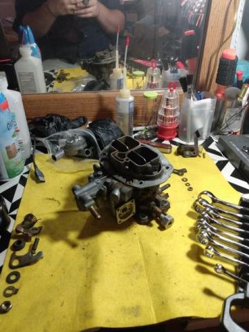

    haha, you guys are awesome. well I finally the carb in cleaned it up really well. ready to rebuild it I'm gonna build a bracket to mount the choke assembly (I dont have the cash to get a choke housing)
    my question is what would be the ideal jetting for the 2.0?
    (at the bottom of the bowl)
    140 on primary
    137 on secondary
    main jets
    60 on primary
    50 in secondary
    emulsions are both f50
    thanks again I'm still learning this stuff.
