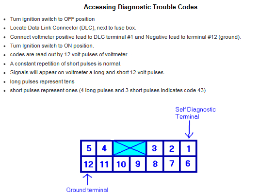

    That empty plug is the diagnostic port. If you have a check engine light on you should be able to check it with a volt meter that has a needle or a 12 volt LED, pin 1 on the port is positive and pin 12 is negative.
