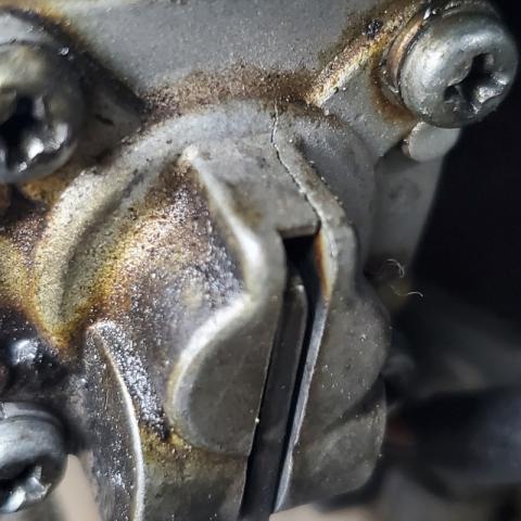

    My baby is a 1987 Ram 50 with the stock 2.0L and Mikuni carb... The carb doesn't have anything printed or stamped on it that I can find except "Mikuni Corp". There are a number of other little problems with the truck, but this one is the most pressing at the moment.
    1. Which Mikuni carb did the 2nd gen 2.0L come with?
    2. Where can I find replacement parts without buying a whole new carburetor?
    The accelerator pump has a hairline crack and the diaphragm is shot, and intermittently leaks fuel.
    The truck also starts, idles, and seems to run fine, but randomly loses power. Initially, I thought it was simply the original coil and resistor, which I found and replaced using information from this forum, but she still sputters and loses power at random times. I'm hoping the accelerator pump is the other half of the equation, but I need to find a replacement to be able to test that hypothesis.

    If the body of the carb is cracked, it can't be repaired. The resin they are made from doesn't accept any kind of adhesive or epoxy filler and there are only a few parts on them that are available new and 'can' be replaced. You will need to hunt down another carb from a JY - the carb itself is designated as a Mikuni 32-35DIDTA but there are a number of different variants depending on year and emissions requirements. These carbs are found on Mitsubishi vans as well but it will need to be from another 2.0 as the jetting from a 2.6 will cause it to run rich. If you haven't pulled apart a carb before, the Mikuni is either your worst nightmare or a perfect baptism of fire. Be aware that, if a carb you choose to use hasn't been apart for 15 years+, it will be due for an overhaul anyway as the diaphragms and seals are past their serviceable life.

    Thank you so much, the body of the carburetor isn't cracked just the accelerator pump cover. I'm hoping I don't have to find a scrap carb just to get that part. Also where would I order a new accelerator pump diaphragm from? I tried through AutoZone and it was almost twice the size of the one I need.
    Pump cover isn't a serviceable component so you need to do some JY diving for a replacement. They are all the same. If the accelerator pump diaphragm is tired you won't be getting a decent stream of fuel into the primary throat on open throttle take-off.

    As long as it's idling, it's fine... but if you rev it a couple times, it starts leaking.

    I have a spare cover and diaphragm, both used and look okay. If you don't find anything near you, PM me an address and I'll send them to you.
    Also, the carb number is printed on the top, air horn of the carb between the mixture control valve and the secondary throat. Remove the air cleaner and its rubber gasket to see it if it hasn't been rubbed off with age or removed by a rebuilder. Here's a pic of it:
    If your carb has an electric choke, its number should be similar to that in the picture.
    That is an odd looking carb. Fuel line going into the accelerator pump is from the top? And how the hell did the PO crack the damn thing? I have a bad feeling the guy put the diaphragm in the wrong way and torqued it til the cover bent and cracked. There is a possibility of internal damage too...

    The Mikuni is a bit of an odd duck. The fuel line in Dr. Steel's pic is the tank return line. There is an inlet line to the pump reservoir not shown in his picture. It comes from the restricted port on the stock fuel pump. Not sure why the pump needs a separate inlet since there's an internal passage from the float bowl to the pump. Maybe it's to keep the pump charged when float bowl fuel levels are very low. Who knows the mind of Mikuni.

    Got the parts, got them put in, and at least now she's not spraying gasoline out the side. But she's still sputtering when under load and sometimes she runs fine and I can get up to highway speed, but most of the time she won't get over 35. Acts like she's out of gas.
    The fuel pump is new, the carb is new but the previous owner tried to "tune" it. Original ballast resistor went bad, replaced it with the one O'Reilly's said was correct which somehow killed the coil so I got the coil and resistor kit off eBay. New fuel filter as well. I need this truck to run well enough to get me back and forth to work until I can afford the Weber upgrade. Any advice on the multitude of adjustable screws? Or what to look for that I'm not thinking of. I'm not losing power all together, but I can't tell if it's not getting spark when it does it or if it's not getting fuel.

    I forgot to mention, when it sputters, sometimes if I feather the throttle it recovers. Sometimes it makes it worse. If I floor it, it dies. I assumed since the accelerator pump was spraying fuel out the side when it would sputter that that was the problem. And while it does run a little better, the sputtering seems to be random and makes trying to go anywhere nearly impossible.
    I'm at a loss and I don't have the money to do the Weber conversion. This carburetor was bought at the same time as the fuel pump by the previous owner.
    Also, I try to run only non-ethanol.
    It's like it's not getting enough fuel or not getting enough spark and I don't know how to diagnose which problem it is. So any help will be greatly greatly appreciated.

    Another odd thing is that the choke doesn't open all the way. I have no clue how to adjust that. Maybe at highway speed it's not getting enough Air instead of not getting enough fuel?

    If the choke isn't opening it will sputter from lack of air. It isn't really adjustable but with a fully warm engine, the choke butterfly should be completely open (vertical). If it stays mostly closed, check that the red wire to the choke has 12v while the engine is running. If not, check the wire on both sides of the eight-pin connector, and then the same red wire at the choke relay and the black/white wire to the choke relay. The relay is in the "device box" attached to the driver's side wheel well.
    Check the accelerator pump operation. Remove the air cleaner top with the engine not running. While looking down into the primary throat, quickly open the throttle linkage. You should see a small stream of fuel squirt down into the primary venturi. If nothing or it only drips some, the accelerator pump circuit is obstructed and that can cause the drivability issues you described.
    Lastly, with the exception of the idle speed screw, resist the temptation to adjust any of the other screws. Most are set at the factory (or by a rebuilder). "Adjusting" them can make matters worse at this point.
    There is definitely some minor issue with the choke. I'll have to check the electrical stuff after work. It only opens 3/4 of the way. I can move the plate all the way open, but it gently springs back to three quarters open as soon as I let go of it. It shouldn't be the wax pellet issue, because the carburetor is less than 2 years old. Previous owner bought a brand new mikuni and fuel pump, it still couldn't get it running the way he wanted it after screwing with the settings on the carb. It ran fine until the original resistor failed, but it never ran optimally as long as I've had it.
