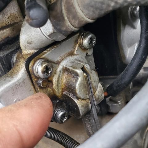

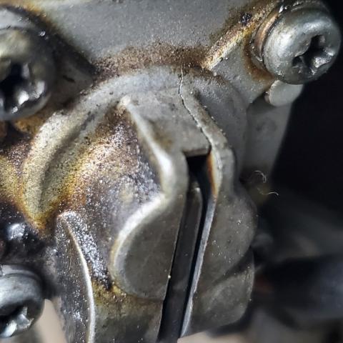

    My baby is a 1987 Ram 50 with the stock 2.0L and Mikuni carb... The carb doesn't have anything printed or stamped on it that I can find except "Mikuni Corp". There are a number of other little problems with the truck, but this one is the most pressing at the moment.
    1. Which Mikuni carb did the 2nd gen 2.0L come with?
    2. Where can I find replacement parts without buying a whole new carburetor?
    The accelerator pump has a hairline crack and the diaphragm is shot, and intermittently leaks fuel.

    If the body of the carb is cracked, it can't be repaired. The resin they are made from doesn't accept any kind of adhesive or epoxy filler and there are only a few parts on them that are available new and 'can' be replaced. You will need to hunt down another carb from a JY - the carb itself is designated as a Mikuni 32-35DIDTA but there are a number of different variants depending on year and emissions requirements. These carbs are found on Mitsubishi vans as well but it will need to be from another 2.0 as the jetting from a 2.6 will cause it to run rich. If you haven't pulled apart a carb before, the Mikuni is either your worst nightmare or a perfect baptism of fire. Be aware that, if a carb you choose to use hasn't been apart for 15 years+, it will be due for an overhaul anyway as the diaphragms and seals are past their serviceable life.

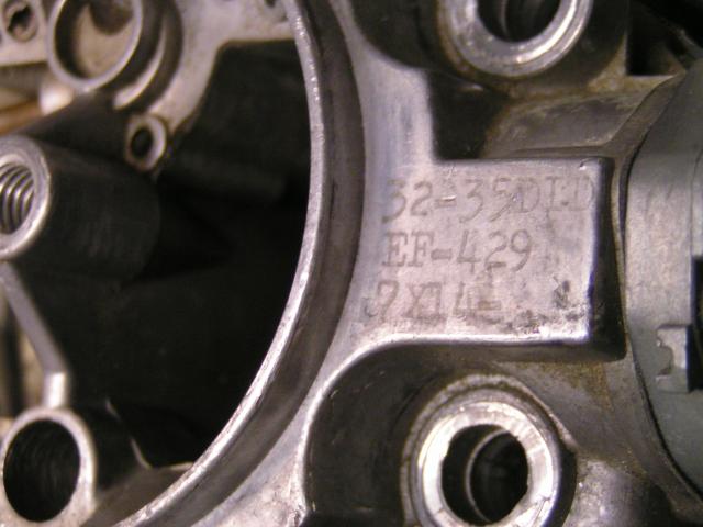

    Also, the carb number is printed on the top, air horn of the carb between the mixture control valve and the secondary throat. Remove the air cleaner and its rubber gasket to see it if it hasn't been rubbed off with age or removed by a rebuilder. Here's a pic of it:
    If your carb has an electric choke, its number should be similar to that in the picture.
    That is an odd looking carb. Fuel line going into the accelerator pump is from the top? And how the hell did the PO crack the damn thing? I have a bad feeling the guy put the diaphragm in the wrong way and torqued it til the cover bent and cracked. There is a possibility of internal damage too...

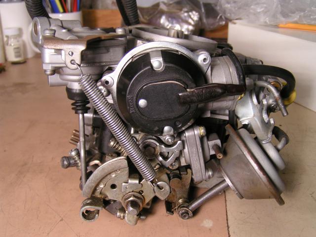

    The Mikuni is a bit of an odd duck. The fuel line in Dr. Steel's pic is the tank return line. There is an inlet line to the pump reservoir not shown in his picture. It comes from the restricted port on the stock fuel pump. Not sure why the pump needs a separate inlet since there's an internal passage from the float bowl to the pump. Maybe it's to keep the pump charged when float bowl fuel levels are very low. Who knows the mind of Mikuni.

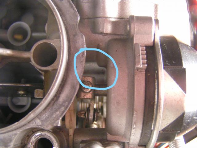

    The accelerator pump only works from closed to open throttle - literally just a single shot of fuel to stop it from stumbling on a lean fuel mix. Don't go messing with the screws on the linkages. There are fast idle adjustments and choke settings affected by them and not knowing when or how to adjust them can turn ugly. Resetting the choke butterfly spring tension on the thermal wax pellet choke takes near superhuman strength to override the main loading spring and can crush a finger lol (and that is only IF you are able to get the anti-tamper screws off it to make the necessary adjustments). The actual wax pellet 'is' still available but you will have nearly zero chance of successfully installing one. *extra tip on the wax pellet choke - if you see a thick looking grease built up around the actuator rod on the choke assembly, that is the wax that is meant to be inside it and it has failed. Yes - the Mikuni is a BIATCH

    Mitsubishi went to an electric choke for the 87-89 model years. If the firewall side of the carb looks like this, there's no wax pellet to worry about:
    If the choke butterfly is mostly opening, it's probably not the issue. But to be sure, you can temporarily "fix" it in a fully open position. With engine off and air cleaner removed, manually open the throttle so you can move the butterfly to the fully open position. Then jam a piece of wood, rubber or plastic into the space circled in this pic:
    Make sure the butterfly is nearly immobilized in the open position and that the jam piece won't interfere with installing the air cleaner and its gasket. Install the air cleaner and test drive it. If it still has drivability issues when hot, it's not the choke. Then check the accelerator pump operation, if you haven't already.
