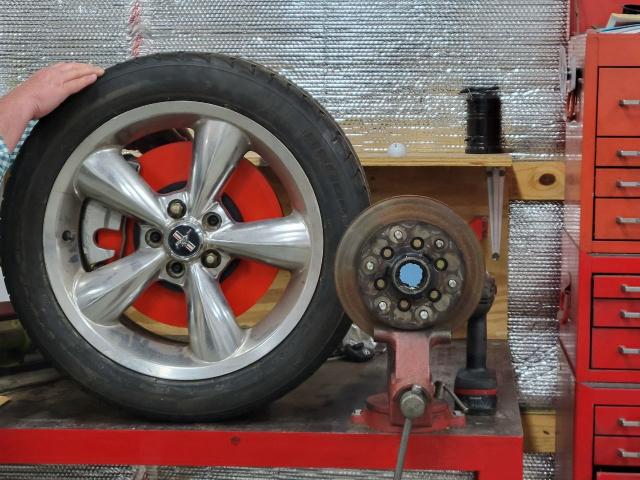

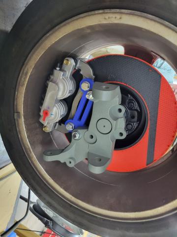

    Head and block are in the machine shop now; will be a few weeks before I get them back. We have narrowed the Ford 8.8 and we're now in the process of replacing all of the steering and suspension components, installing the drop spindles and 4-wheel disks. It's going to be a slow process, but we are making progress!
    Those are ginormous brakes dude. The seatbelt will split you in quarters if you stand on the brake pedal hard All the cosmetics on your truck tie in together - mid blue and chrome/polished alloy works well. You're going to need to 'massage' the firewall to gain clearance for the CAS on the rear of the head. Option #2 - move the drivetrain forward to increase clearance, and use electric thermofans for cooling which is what I would've recommended anyway as these truck engine bays suffer from heat soak (down side is shifting the drivetrain weight forward which isn't great but you're not building a track weapon) I've thought about 1G Eclipse/Talon headers being a possibility for this kind of transplant/head swap but they would need to be modified to clear the engine crossmember.

    LOL, yeah, we decided against those rotors, that was something my Son modeled up and 3D printed just to check clearances.

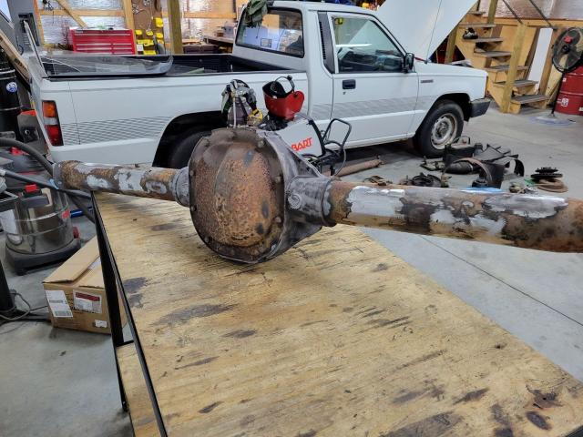

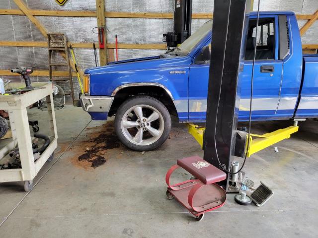

    Got the 8.8 and the lowering spindles installed.
    Had some issues with the polymer bushing kit I ordered. The bushings supplied for the front spring eyes were too small. I contacted the vendor and was told they were the correct number, and they had no other options. We had some Prothane number 2087 bushings left over from the '68 Mercury Cougar project we're working on and found that these are the correct diameter and have the correct bolt hole size, they are just a bit too wide. We cut about 1/16th off of each one and they fit perfect.
    We'll be moving on to the rest of the suspension and brakes next...

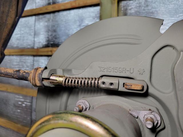

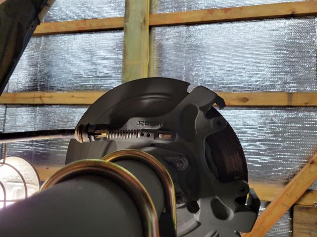

    Got the park brakes sorted now. Hopefully we'll get time to finish the front suspension coming weekend. Still waiting on the machine shop to finish the head and block.
    Did you have any hurdles with getting the E-brake cables to fit?

    Nothing major, it just took a little time. We made new ends for the existing Mitsu cable out of 3/4" stock. We shaped them similar to the ends that the Ford donor truck used, cut the Mitsu cable and grafted the new ends on and secured with 1/8" set screws. We also used the Ford return spring, which had to be cut down a bit.
