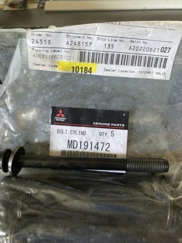

    The 4g63 SOHC head bolt cannot be used in place of the 4g64
    SOHC (8 or16 valve) head bolt .
    SOHC 8V / 12V 4G63 -MD040514 - 12 X 105 MM
    SOHC 8V/16V 4G64 -MD191472 - 11 X 118 MM
    I have contacted ARP technical and was rather curtly informed
    " we do not manufacture anything for that engine configuration "
    The 4g64 8v forklift bolts are a direct fit as most are the MD191742 PART NUMBER
    just rebox/bag with large variance of pricing, always to the increase side of course.
    However, the below are available in multiple groups from
    MITSUBISHI DIRECT PARTS in Florida 1-368-259-1599.
    I just called--- 8/10/2022, an checked availability as my order
    (PIC BELOW) was 2 weeks old.

    The MD191472 are for 7bolt engines,i have made that mistake in the past
