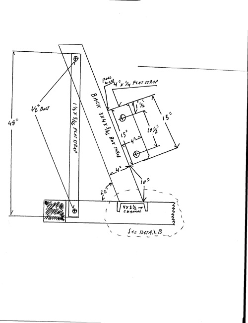

    I have started working on the plans. Here is the first of 2 PDF files to build a hoist that will lift engines with confidence. And it can pull a V8 out of your boat with plenty of arm to spar.
    I have lifted the back of the D50 off the ground and rolled it around with out any problems, removed the radiator from the freightliner with no worries. And the lift points are 7 foot in the air plus chain. The heaviest things i have lifted was my Liberty Gun Safe. It weighs 670 lbs.
    The PDF has more detail.
    part 1: Click Here for General Overview.
    Part 2: Click Here for Upper Lift Arm.
    Part 3: Click Here for Back & Back Support.
    Part 4: Click Here for Legs & Base.
    Parts List:
    BOX TUBING
    3" X 4" X 3/16" LIFT ARM
    2 1/2" X 3 1/2" X 3/16" LIFT ARM EXTENSION.
    3 1/2" X 3 1/2" X 3/16" LEGS
    3" X 3" X 3/16" LEG EXTENSION.
    1 1/2" X 1 1/2" TRUSS SUPPORT
    FLAT STRAP
    1 1/2" X 5/16" TRUSS & BACK SUPPORT
    4 1/2" X 3/8" UPPER PIVOT
    4" X 1/2" CASTER MOUNTS / FEET
    "C" CHANNEL
    3' X 2" X 3/16" LIFT ARM HYDRAULIC RAM BRACKET
    4" X 2 1/2" X 3/8" LOWER MOUNTING POINT FOR UP RIGHT
    4" X 1/4" LOWER RAM MOUNTING POINT
    5" SOLID STEEL CASTERS.

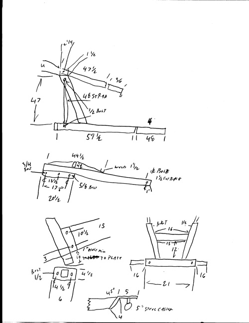

    My Wife can't under stand how I can take a crappy sketch that took me 10 minutes to measure and draw up, then pull 4 full pages of details and a parts list out of it. I blame it on my Dyslexia, I see things the way it should be, then it gets tossed in a box with a bunch of other junk. Mix it well and pour the stuff on the floor. Then extract the true shape I was thinking about. But the majority of the time I don't use this much detail. It just remains locked in the box tell I cut and weld it. Some of my best hieroglyphics are on 4" X 4" note paper. Thats where the build truck was born.
    Here is the way I make notes. Does it even look like the pages above? To me it has every detail you find in the pages above. Strange hu???? I still can't figure it out how it works but it does...
    Works for me. Perhaps it's because I'm a touch dyslexic as well. The sketch is just an anchor for what's in your brain, I think?
    I know you wanted to look at Solid Works for such things, but have you ever played with Sketchup? It is no good for exporting to a CAD/CAM compiler, but is GREAT for fiddling about and planning projects in 3D. And? It's free!
    It has provision for showing all dimensions, internal and external, etc. You can also texture your model and render it with a number of open source rendering programs.
