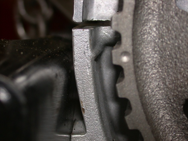

    Here is the way to align the timing mark on the 2.0 / 2.4
