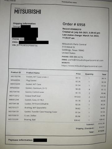

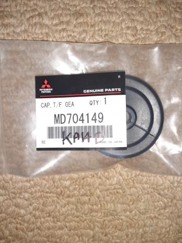

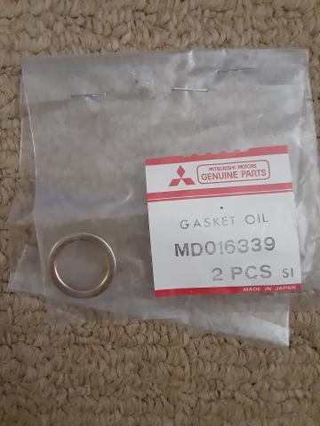

    1,583
    KM132 M/T 5 Speed Transmission (what digging I've done so far...)
    https://norcaltransmissionparts.com/...esult/?q=KM132 <---- REBUILD KITS
    https://www.youtube.com/watch?v=h0zwDMJIBtY&list=WL&index=64
    itsubishi Parts Central
    Mon 7/5/2021 7:13 AM
    If you are not going to take the transmission out of the truck, here are the gaskets and seals you can replace while the transmission and transfer assembly are still in the truck -
    Trans pan Gasket - MD703796
    Filler Plug Seal - MF660036
    Drain Plug Seal - MD016339
    Back-up Light Switch Seal - MF660034
    Shifter Gaskets (2x) - MD704190
    T/F Case Rear Driveshaft Seal - MD712012
    T/F Case Front Driveshaft Seal - MD712012
    T/F Case Filler Plug Seal - MB001294
    T/F Case Drain Plug Seal - MB001294
    T/F Case Output Shaft Bearing Cover - MD704138
    T/F Case Shifter Gasket - MD704159
    T/F Case Hi-Lo and 4WD Indicator Light Switch Seals - MD660034
    Also, one thing I recommend, if you are taking the shift lever off to replace the 2 gaskets - on the bottom of the shift lever is a plastic bushing you may want to replace. It wears our and eventually breaks, making it impossible to shift. If it is not broken, but worn, replacing it will tighten up any looseness in the shifter. - Part number MD701577
    OEM Parts for KM 132 Mitsubishi 5 speed M/T
    NOTES:
    MD725209 is the input shaft bearing
    These parts still available through USA suppliers
    Amayama.com supplies parts for Mitsubishi Gen1 Strada truck which has a 5 speed M/T on a 2.5L diesel engine ~ maybe it is a KM132 transmission..?
