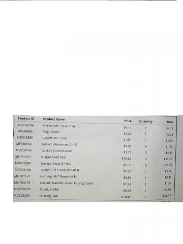

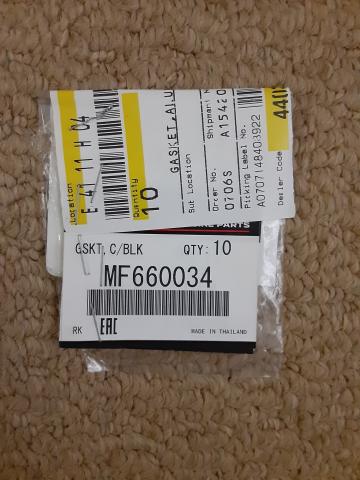

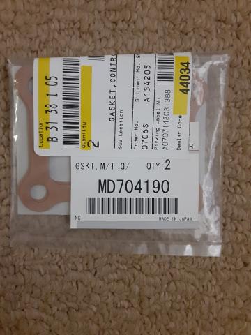

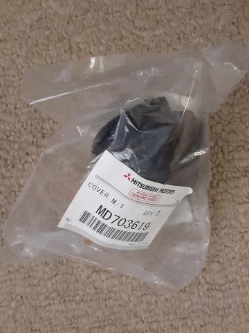

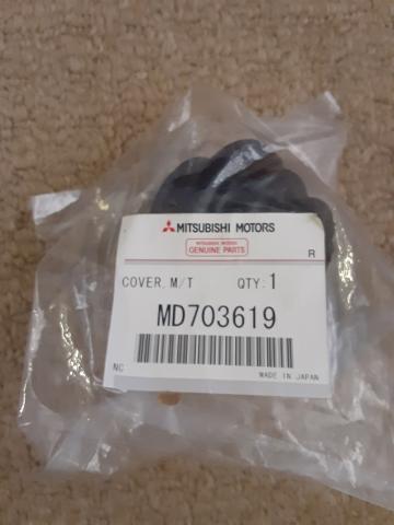

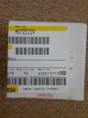

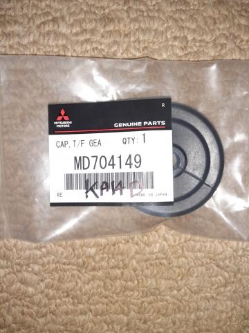

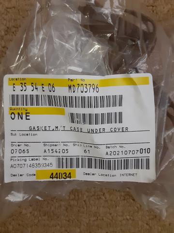

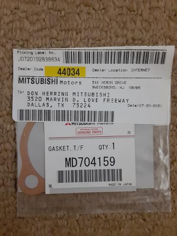

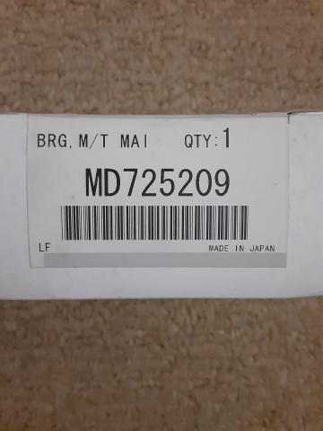

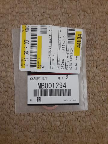

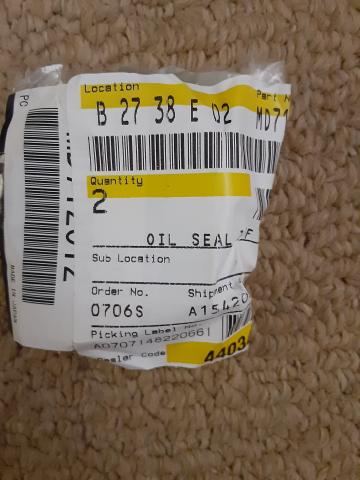

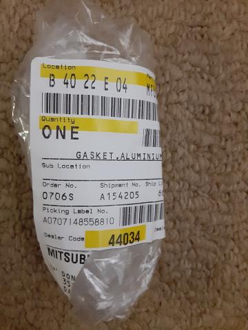

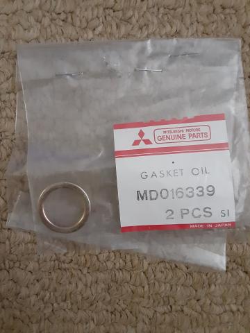

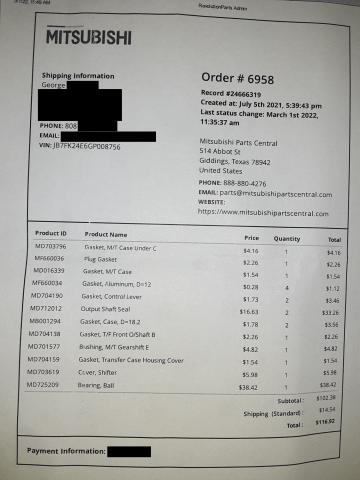

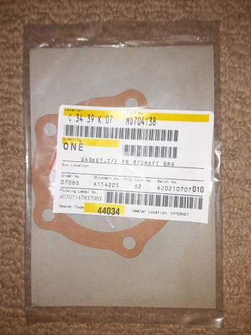

My truck's bearing noise happens when clutch out & neutral gear ~ clutch in no noise ~ I bought Royal Purple 90W gear oil at NAPA when they had it on sale ~ draining the 5 speed manual transmission, the fluid looked fairly clean but tinted brownish ~ the new fluid lowered the transmission input shaft bearing noise by about half ~ I don't worry about a little noise any longer; it's too time consuming & too expensive & too much work to fix a bearing that still works ~ I need the truck to get groceries, it's my only ride ~ here is a list of Mitsubishi OEM parts still available in USA ~ Amayama and others might have more parts (?) hope you can read the print (?)
EDIT: I just received all these parts in a box at my place; so I know they are available...

Trans pan Gasket - MD703796

Drain Plug Seal - MD016339
Back-up Light Switch Seal - MF660034
Shifter Gaskets (2x) - MD704190

T/F Case Filler Plug Seal - MB001294
T/F Case Drain Plug Seal - MB001294
T/F Case Output Shaft Bearing Cover - MD704138
T/F Case Shifter Gasket - MD704159

OEM Parts for KM 132 Mitsubishi 5 speed M/T
NOTES:MD725209 is the input shaft bearingThese parts still available through USA suppliersAmayama.com supplies parts for Mitsubishi Gen1 Strada truck which has a 5 speed M/T on a 2.5L diesel engine ~ maybe it is a KM132 transmission..?
