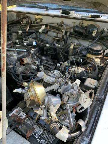

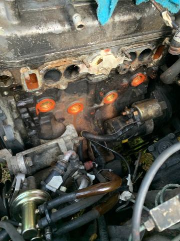

    I needed to replace the freeze plugs on the drivers side of my 2.0L "u" engine. In order to get to those plugs I had to take off the carb, inlet manifold, distributor, and fuel pump. I labeled all my connections religiously and put it all back. I think everything's connected correctly but it's possible something is amiss.
    I am getting spark to the plugs and there is fuel entering my carb from the pump.

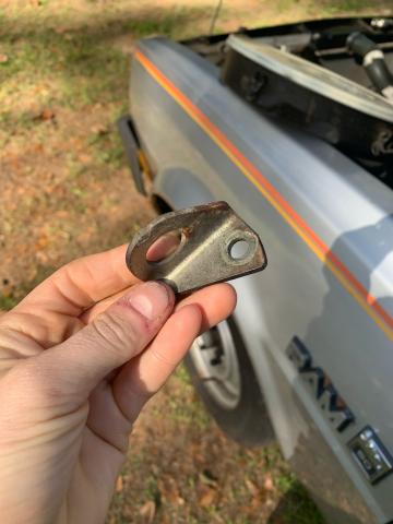

    -i have one extra bracket left over after putting it back together ::big sigh:: but i can't imagine that is what is messing me up. (see attached photo)

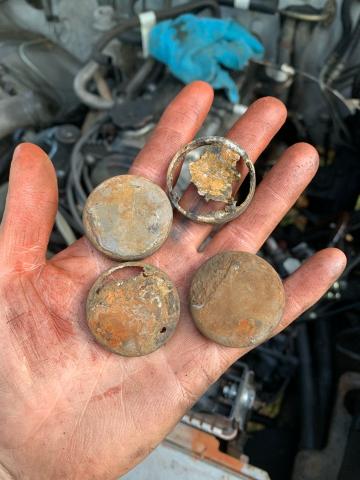

    also, these may be the worst corroded plugs you have ever seen. (i did beat them up getting them out, but still)
    Spare bracket is the engine lift point (don't need it until you 'need' it) I think the timing is out - check the distributor. Make sure the crank pulley is pointing @ TDC #1 and have a look at where the rotor in the distributor is aiming, remove and adjust the distributor as needed. Check that the carb is getting primed with fuel and the fuel lines are hooked up to the right connections on the carb. The fuel pump itself may be tired and the new spring is fighting it enough to restrict fuel (don't know if this is the case but it's a possibility...)
