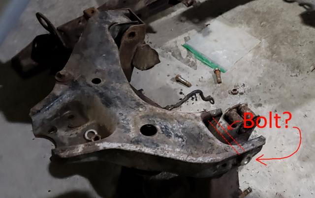

If you haven't done this yet, you need to keep the torsion bar end connected to the control arm. The torsion bar will hold the key bolt in place when loosening the nut.
