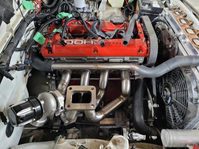

    This piece ends up being the runner that feeds the wastegate from the collector. It required way more grinding on the right side to get it to mate properly. To make the hole in the collector I used my plasma cutter, then cleaned it up and opened it up the last little bit with the carbide burr on the die grinder.
    Wastegate mounted and also made a quick downpipe. The 3" downpipe fits but it doesn't leave much room between the frame where the idler arm is and the trans bellhousing, so next time I pull the trans I am going to clearance the corner of the bellhousing just to try and prevent any rattles.
    My coolant pipe that goes from the thermostat to the upper rad connection. Some stainless 316 tubing from an old valve at work that we recently replaced and had to retube with larger tubing.
    This is with it in place. I do want to make some little tabs yet to secure it to at least one of the valve cover bolts, mostly to prevent any rattles. It most likely will absorb some of the radiant heat from the header, but I dont think it will get too hot for the rad to handle, most of the heat should be by the collector?

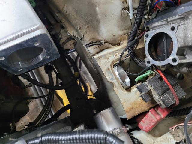

    This is showing the lip on the inner fender that I had to trim for the intercooler pipe, also trimmed down the battery tray. The battery still fits fully on the tray. Perhaps in the future it will be relocated but for now this works fine.
    This shows the intercooler pipe on the drivers side. Its tight, a lot of bends, and the DBW throttlebody is mounted on the intercooler outlet. The combination of bends and couplers should allow enough flex to not tear or break anything when the motor torques up, I couldn't really see another way of doing it with this intercooler and intake.

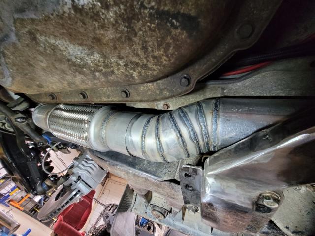

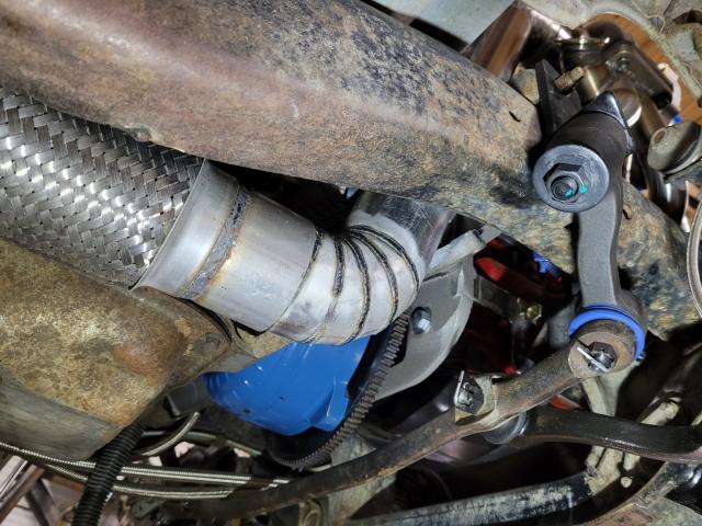

    Downpipe to the flex joint and flex joint to the first piece of exhaust pipe that runs to a resonator.
    Its pretty tight in there for a 3" exhaust but it shouldn't rattle.

    Whoa, hold up. You mounted the throttle body on the intercooler? I've never heard of it being set up like that before. And that is not a transmission mount - that is an integrated frame rail brace. This thing is being built like a tank! You're using some very unique lateral problem solving design principles.
    Geezer approves
  7. #57
    11-12-2021
    Geezer approves
    haha thanks. I built a X cross brace under my LS3 swapped BMW before to help with chassis flex, kind of had that idea when building this trans mount. Figured integrating the trans mount and driveshaft loop together would help to stiffen things up a bit. It can't hurt. Was also debating on running a 1.25" or 1" piece of tubing from the front edge of the lower portion of the chassis 4 link mount up to the back side of this x brace thing, not sure if its going to be a noticeable change if I do i though.
    As for the throttlebody on the intercooler, if anything I can see some possibly idle control issues but doubt it? Just trying to think of any issues and really its maybe a cubic foot or so of volume?

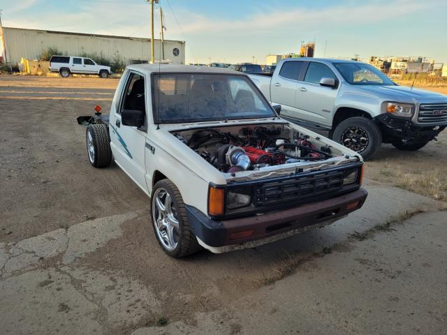

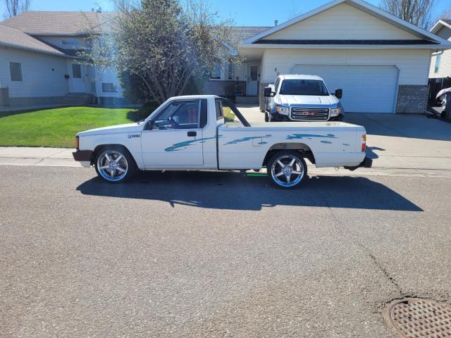

    Its been a while since I updated this. I did get it on the road this summer, late in the season but it was on the road. No races for it this year. I got tired of the oil pan that was in there slowly seeping oil out of the flange for the turbo oil return line and a few other random places that I tried to fix, so I drew up and had some stuff cut, now the pan has a better baffle and more capacity, better turbo oil return location, plus no leaks. Was welding it on an old spare block I picked up from the wreckers.
    First trip out of the shop. Had some magnetic trailer lights hooked up for brake lights.

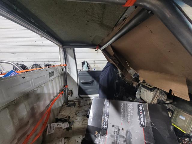

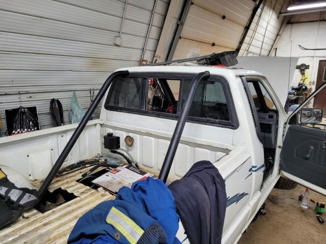

    I put the new head gasket on it last fall then started tearing into the inside of the truck to build the roll cage. 6 point cage with removable door bars, most of it tig welded. Did the tig because its easier to weld upside down in some spots and can get into smaller/tighter areas. I couldn't move the b-pillar hoop further up unless it came forward at the same time. Because of this I had to notch into the window frame which I was hoping to avoid but it all worked out and fits.
    I did fill in all those holes in the box with the original pieces. The extra ones on the drivers side are from the previous owner trying to locate the fuel pump when it was changed... The black box in the front of the box is the new power steering reservoir. Just below that box is an electric power steering pump from a mini-cooper. Currently its wired up to a solid state relay, but nothing triggers it yet. Was hoping to have the ecm control it to automatically turn it on/off but haven't got that far yet. All the lines are hooked up.

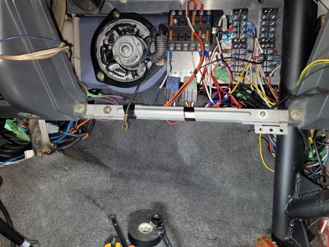

    Because of the cage I relocated the HVAC blower. Drew up this piece and 3D printed it. Blower resistor is mounted in it still. Pretty much the only time this will be used late in the evenings in the early spring/late fall. This locates it just behind the glovebox on the left side.
    Made an aluminum plate and mounted it below the dash, it contains the fuse panel, terminal strips, extra relays and the MPI relay is mounted on the back side. I have cleaned up the wires a bit since this picture, but it still needs more attention.
