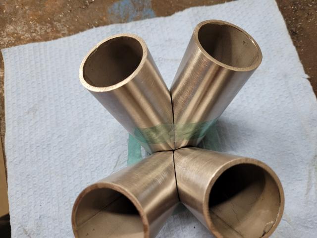

    This is the 3d printed fixture/jig I did. Basically used it to feed the pipes through the band saw to cut close to the right angles, then clean them up a bit with a flapper wheel on a grinder. FYI, stainless cuts real slow, took me about 20 minutes per tube.
    Polished up the tubes and taped them together. This is a task that seems to require more hands than what I have because I never could get it bang on square.
    Then used some of the elbows to help form the transition pieces that will go from the oval on the head to the round turbo pipes. The circumference of the oval on the flange is damn near the exact same as the outside diameter of 1.5" pipe. So I cut four 1" pieces, heated them up, squished in the vice, used a flapper wheel to make them a tad smaller, polished them and squeezed them into the flange ports then tack welded them in place.
    Next step is to start trying to piece together each runner, then find a way to cut a hole in the collector somewhere to put the waste-gate on? Not really to sure what I am going to use to do that or how to do it.

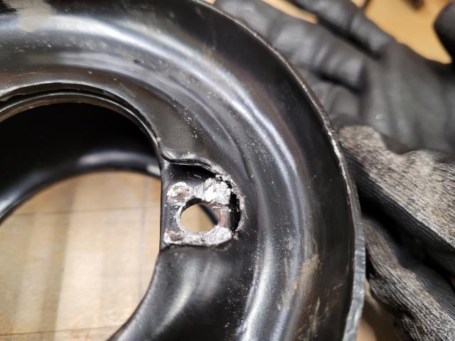

    So I got a new set of lower control arms because I cut the spring pockets off my original ones. Tried to mount the shock under the bracket and use the OEM spring, the QA1 shock is too short for that. Also the adjusting knobs and lower part of the shock housing starts to interfere with the LCA. So I drilled out the threaded spots for the shock mount and removed the rest with a chisel.
    I opened up the one side of it to allow the shock to sit flat on the LCA and not the spring pocket piece, still need to square up the hole on the other side and grind off the remaining piece of weld that is left.

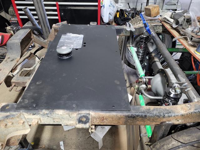

    Yesterday after work I finished up the work on the fuel tank and dropped it off to get powder coated, also spent a bit of time on the one front corner.

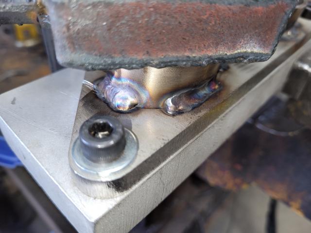

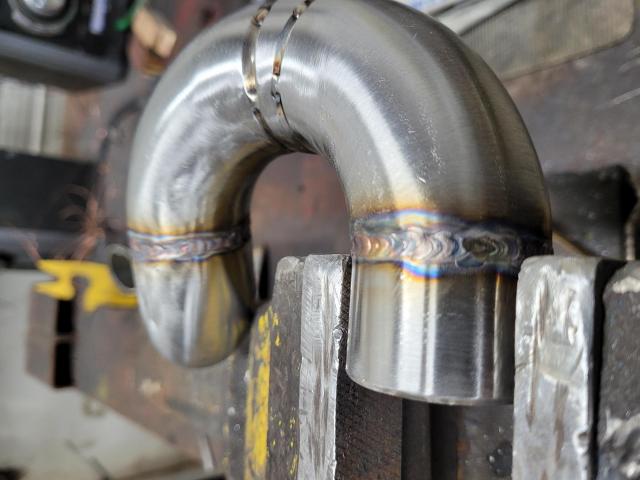

    Welded up the collector for the turbo. My hand control definitely needs more practice, but its welded for now. I am going to put a second weld over the first with a thinner filler to get it to look nicer and fill in the undercut areas a bit. The flange weld isn't undercut but on the collector tubes there are spots that are. Some of the tube welds are oxidized a bit because of the extended tungsten stick out I needed to get in there. Also going to have to work on the heat control more when its time to weld the tubes together, I can see it warping and twisting more if I keep that up lol.
  14. #39
    Your welds are thicker than the ebay header welds. Anyone who is critical of what you're doing should try it themselves. You're not going to get many cake-walk welds making these either. This is one skill I wish I could get invested in... can't wait to see the end product!
  15. #40
    1,583
    Good looking welds colt ~ there will be less heat input if you stop welding more often or when position becomes uncomfortable ~ n' let things cool down ~ try to increase your speed of travel while welding it helps reduce heat input too ~ this minimizes discoloration of the metal BUT the real importance of minimizing heat input is to retain the qualities of the base metal i.e. Crest keeps it's corrosion resistance ~ You deserve a straight A in welding Sir..!

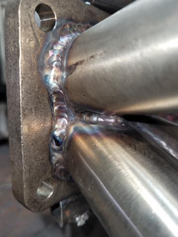

    Picked up my fuel tank from getting powdercoated, vacuumed it out, rinsed it, then let it sit in the sun with a shop vac blowing into it to ensure as much moisture was out if it as I could get. Dropped it into the frame, need to mount the pump, sending unit and wire it up next.
    This is what the manifold ended up looking like. Since this pic was taken I did polish the tubes yesterday and its ready for welding.
    The little purge box I made sitting ontop of one of the ports for when I was welding the adapter sleeve into the flange. I did fully weld these sleeves into this flange and its still fairly flat. Welded this side of the sleeves and the inside of them too (they are pressed into the holes a bit).
