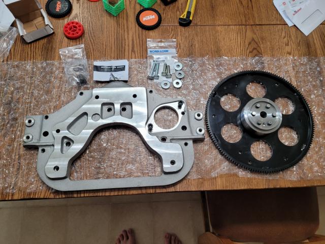

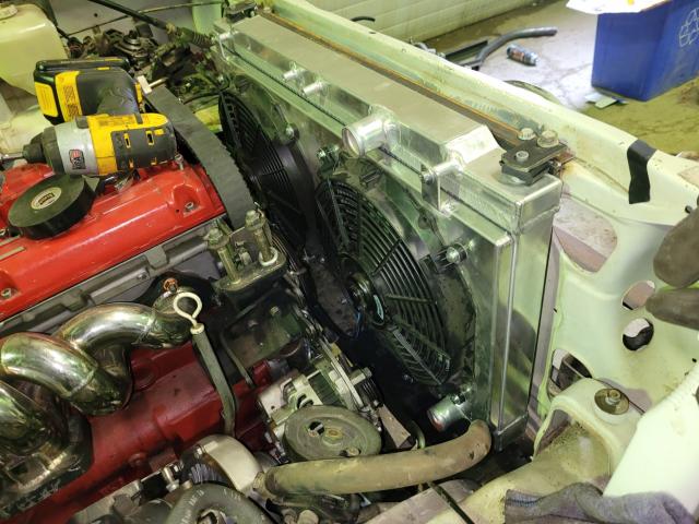

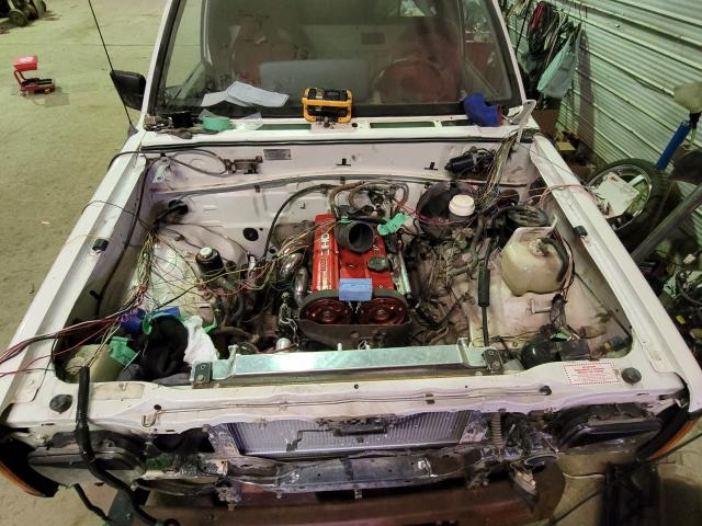

    Removed the original wide block 2.4. Positioned the narrow block 2.4 with the gm 4L80 trans bolted to it using Hinchers setup. Made my motor mounts to move the motor forward. Installed new cams and rockers in the head along with a truck water pump. Went with the thermostat housing that comes straight out to the side. I have a new crank and rods to make it a 2.1 destroked engine which is the future plans of this block.
    The aluminum rad is what I had installed in the talon previously, it fits amazingly well with a new bracket. The sides of the bracket bolt to the factory rad mounts, the bottom of the new rad mount has tabs that the rad posts sit in with a layer of rubber between them, the top of the bracket has tabs that bolt down with rubber again on the top posts.

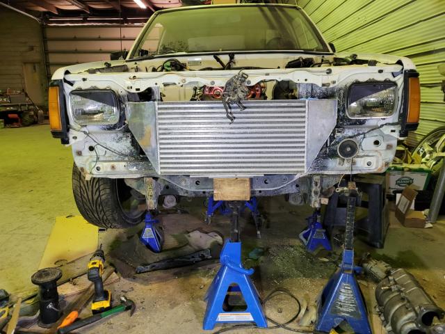

    The intercooler is what was in the talon too. Can't remember the exact dimensions on it but its 3.5" thick and fits behind the factory grill and bumper. The outlet ended up right below the battery tray and will be cut shorter yet, the inlet will be shortened once the turbo is in its new home. Ignore the headlights in the picture, the previous owner did those lol.

    Anyways, the 2.4 engine was previously in a 1990 talon that I had. The engine was put in that car before I got it. I do not know exactly which vehicle it came from originally, but I am in Canada and there are not that many Galants around here. The crank in it is a 6 bolt, and the head on it is a DOHC head that was originally in my Colt 16 years ago with the ports opened up and oversized valves.
    I don't currently have any pictures of the motor and trans bolted together on my computer, I will check on my phone in a bit. They do have to come out once more before spring when i get all the mounts powder coated so I can take some pics then.
    I had to get a different crank shaft adapter made up though. According to the torque converter vendor I was dealing with Bills piece had too much tolerance in the hole where the torque converter pilot goes. The vendor says 3-5 thou max, I was measuring 15. I also had to make two shims between the trans and the block adapter plate to get the converter to pull out of the pump the required amount.

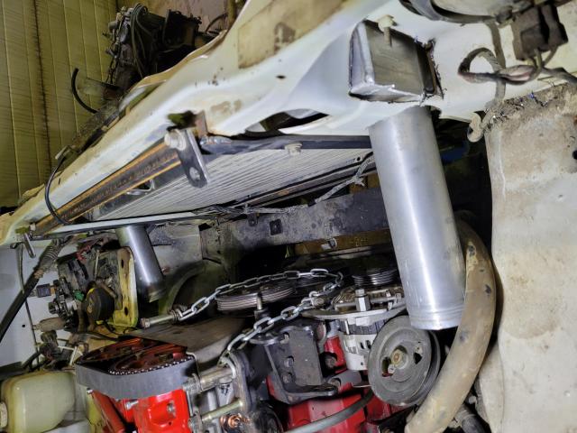

    Back side of the intercooler, also shows the rad frame I built.

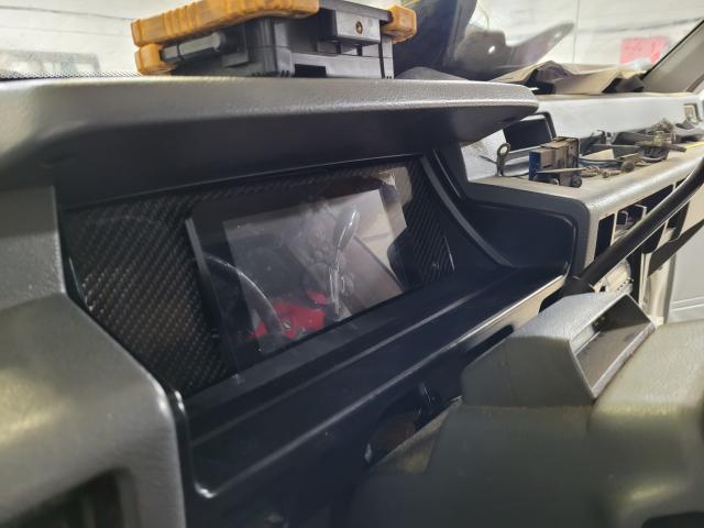

    New dash/instrument cluster is a Powertune Digital unit. Touchscreen, color, gps, basically its a raspberry pi with a pi touchscreen that someone put the work into to build a decent interface and set it up. It comes in a 3d printed case and so far they have great customer support. I have removed mine from its original case and made my own, I wanted to change the orientation of the wire connections and placement on the screen. It has 4 screens that are select-able. One of the default ones is a performance related screen showing 0-60, 1/8, 1/4 mile times and lots of other info. It gets its data from the ECU on the CAN bus network, so basically anything that is wired to the ECU can be displayed on here. The original screen protector is still on it so its got lots of glare right now.

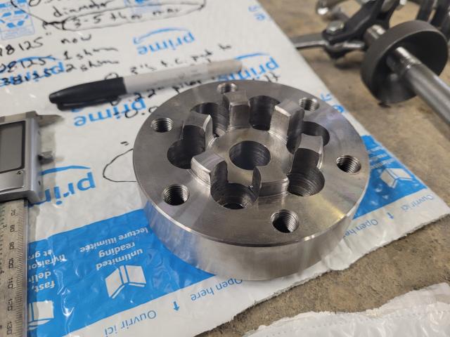

    The 4L80 transmission has a trans brake in it and a few billet pieces inside. Torque converter is hopefully set to stall around 3600 rpm... not too sure yet how well the engine will get there or launch from there. The trans fits well in the trans tunnel. The cooler fittings are close to the tunnel but they can still be removed with the trans in place.

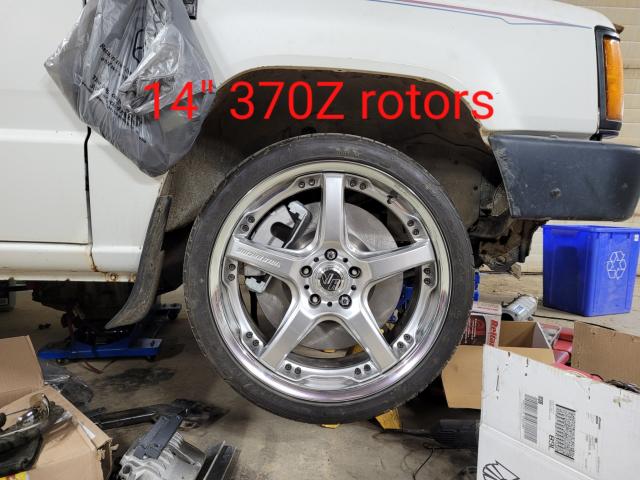

    Front hubs have been changed out to the Toyota pickup hubs to get the 5x114.3 pattern. Front rotors are from a 370Z (14" rotors). The hubs require some machinging or grinding to make the outer diameter smaller to have clearance for the rotor. Front calipers are from a 2000 Chevy V8 Camaro (dual piston), they were cheaper than the Nissan calipers and I think they will still have enough clamping force. The pads don't cover the full face of the disc but for the size of the truck and the size of the rotor I am sure it will be sufficient.

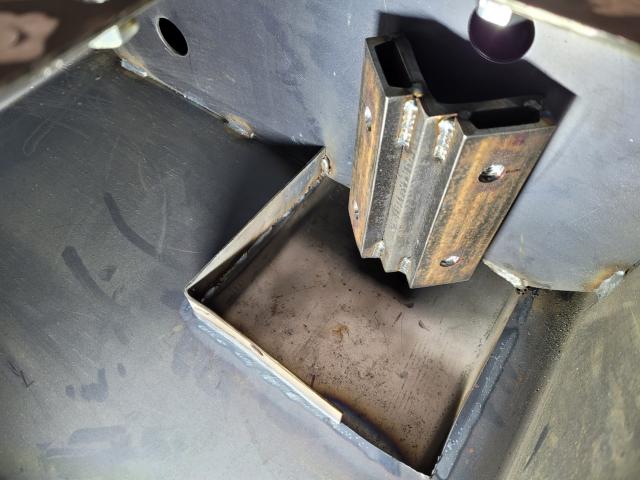

    Between the frame and the outer skin on the front of the box is where I mounted the engine oil cooler and trans oil cooler. They have large fans on them. There will be almost nothing in that area for natural air flow, so I have to watch the temps when I start driving it, see if the fans can keep up. Might need to change something on them in the future. Good thing it doesn't get super hot up here in Canada much. If needed I can try and make an air scoop somewhere to force air into it while in motion like the bottom of my Grand National has for the intercooler, it seems to work for it.

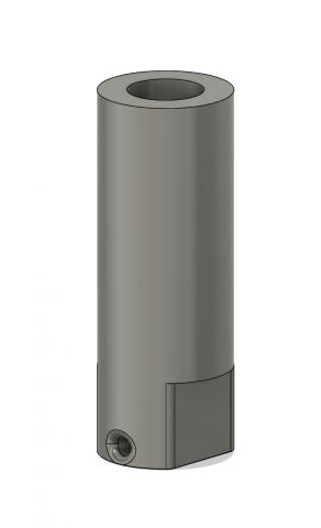

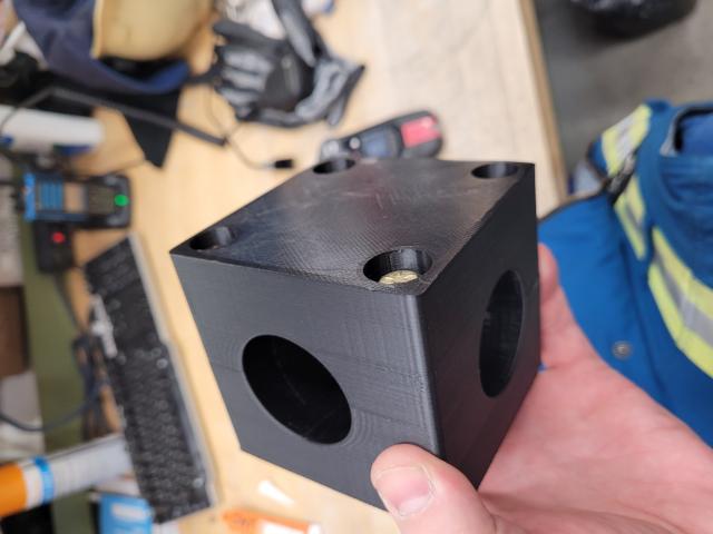

    Figured I would share a few things that I drew up that helped me along the way. I have used a 3d printer now for about 3 years now and I own two different ones. It has helped me a few times on various projects, like playing around with different dimensions to get the positioning correct for my brake caliper adapters so they can be cut from metal. Also used it in the past to help make a new design of a heim joint/ball joint for my other truck for longer travel suspension.

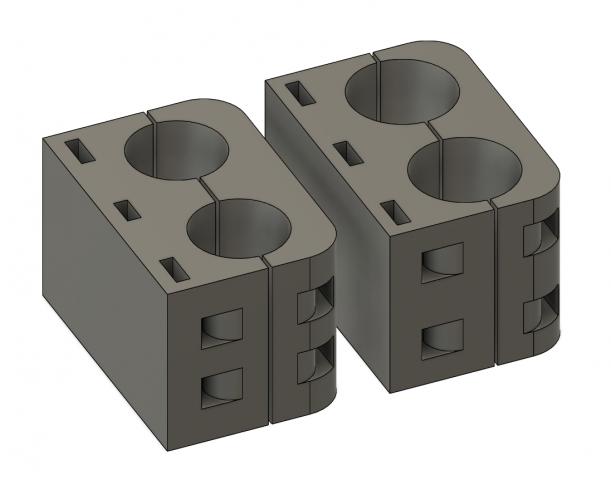

    These are clamps for 6 AN and 8 AN hoses. I 3d printed them from PETG. They are held together with tye-wraps, then tye-wraped onto a metal tab that I bolted to the chassis on the truck. Keeps the lines from rubbing or moving where they shouldn't be.

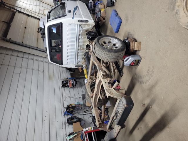

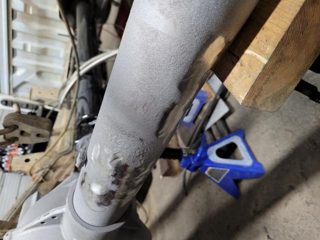

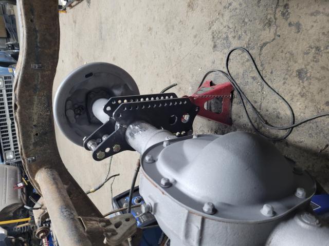

    I didn't get as much done this weekend as I was hoping to, spent all day yesterday driving and getting a snow blower.
    But I picked up the diff from the sandblasters down the street and did the clean up of the axle tubes where the original stuff mounted.

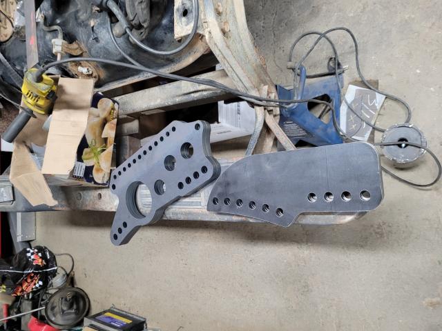

    Also picked up the 4 link mounts from the machine shop, had them cut them out on a water table.

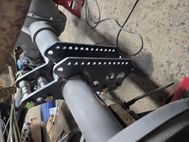

    Cut the axle tube brackets and got them into their new home roughly. Just tack welded them together for now, fairly square but will double check next time I am back at the shop.

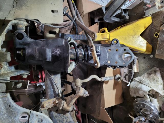

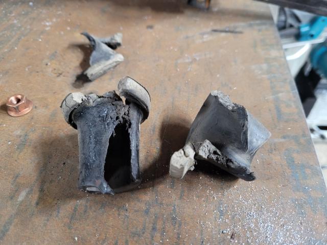

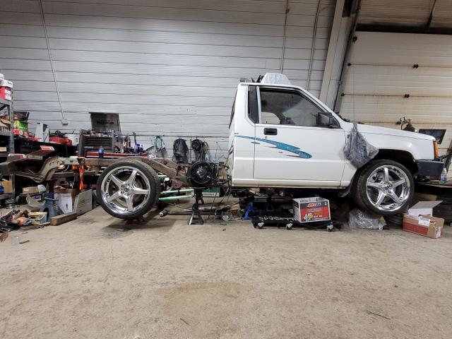

    Its been a while, I have been making progress although its not as much as I was hoping for, but its in the right direction anyways. The 4 link is done, installed. Bars have been powdercoated, diff and the brackets are all bare still. This pic is still with the stock front suspension on.
    And speaking of front suspension... you can say these bushings were well beyond due for replacement. Poly bushings were installed in their place.

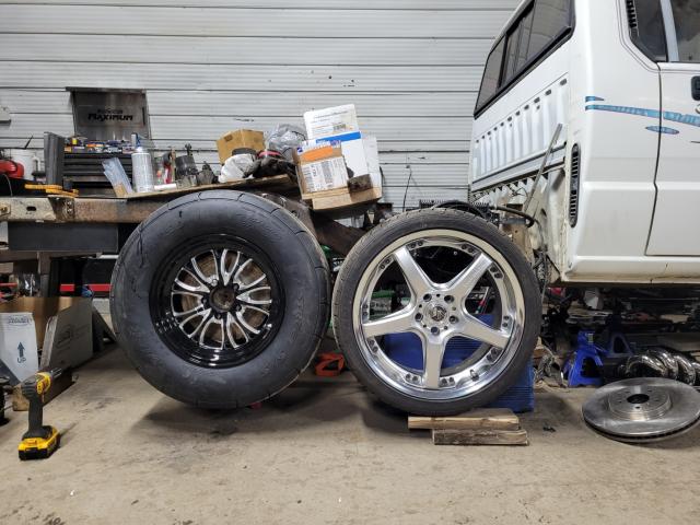

    Just a picture of the 19's that I will run on the street and the 15's for the drag strip. Once this rubber burns off the 19's then it will get something with some more sidewall, I just find it hard to take off tires that have less then a few hundred miles on them just to change them.

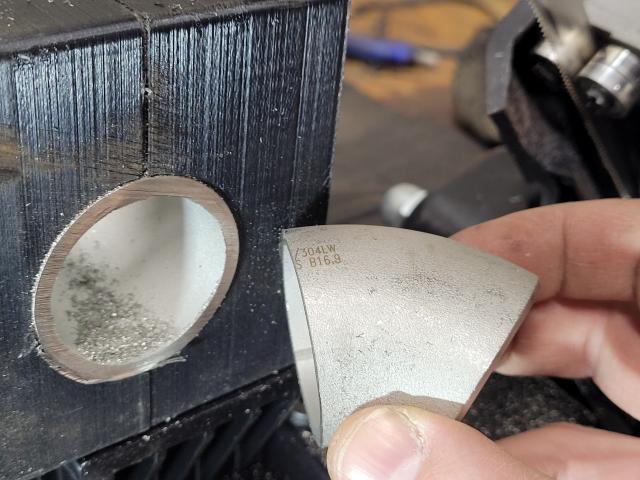

    I 3d printed a fixture to hold the 1.25" sch 10 stainless elbows in the band saw. This fixture allows me to set the angle I need to cut the 90 degree fitting at and secure it tightly in the saw with no slip. The first test cut took about 4 minutes to cut, I got it started then walked away until it was done.

    For the QA1 stuff in the front... I believe the part number was GD401 (dual adjustable Mustang II coilover), it fits kinda. The upper shock mount needs to be lowered about 2 inches (the top of the threaded rod is too short otherwise). With the 8" 375 lbs spring they have, there is too much spring tension when raising up the lower control arm to attach to the upper control arm. The truck was coming off the jackstands with about a 4" gap between the upper ball joint and the spindle. So the either the lower control arm needs to be modified to lower the bottom shock mount, the upper spring pocket needs to be raised, or a shorter coilover installed. I already cut the OEM spring pocket off these arms and welded plates in their spot to help strengthen it back up.
    So for now I am leaning towards buying new lower control arms (with spring pockets haha), installing that with my coilovers with the stock springs in the stock locations. This wont give me adjustable ride height, but will give me adjustable dampening at least for now. Then in the future sometime, use these lower control arms to make a jig to allow me to fabricate new arms, either tubular or boxed unless I find a spring that fits that is shorter than 8".

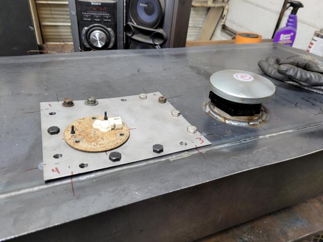

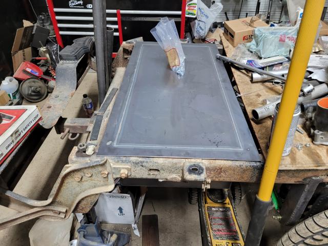

    This is where the fuel tank will sit. It has 2x2" square tubing running across the front and back of it.
    Using the OEM sending unit, had to bend the arm to "calibrate it" for the new tank haha. The fuel filler cap once fully threaded in should fit just below the bed of the box. Planning on putting a cutout into the box bed mounted on hinges with some clasp of some sort to hold it closed. The square piece is removable, this is how the fuel pump is accessed.
    I decided to make the fuel pump mount bracket that will be bolted in place. This way in the future if I ever change fuel pump designs I can just make a new bracket and bolt it in compared to trying to modify a bracket in place or weld in place in a small access hole. The reason for the odd mount, is to run 2 pumps if required in the future too. Only plan on running 1 for now.

    I liked the idea of the Mustang II coil overs but looking at your work I think it would need some radical upper spring tower/shock mount surgery. If it came down to literally lopping the whole thing off, I'd try to figure out a way to make the upper control arm adjustable so the camber could be dialled in. There are prefabricated upper spring/shock mounts that can be welded in, but getting the camber right...
    By the way - nice work with your truck
    I am not certain I want to cut the upper spring pocket off the frame and build something new to fit. Perhaps in the future, if I did that then I would change it to a design where the upper spring mount is on the coilover itself like a traditional strut design instead of sitting in a pocket on the frame. I feel it would give more options for coilover setups. In the past I have made a fwd hatchback into an AWD chassis, it took a lot of measuring but everything passed the alignment and I am not sure I want to do that much again.
