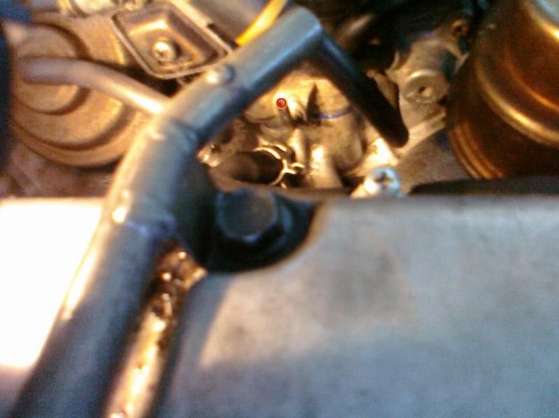

    Here is a pic. the red arrow indicates the problem nipple, the blue arrow indicates another nipple that I have no clue to where it goes. Hopefully when you hear back from the "Super Carb" guy...he will be able to provide a very good vacuum diagram....maybe.
    01-28-2012
    21
    Martinsville, VA
    1988 Dodge Power Ram 50
    A few more pics. Red marks the nipple we've been discussing, blue is another unknown nipple. For the time being I ran the hose (red) into a "T" w/in the PCV hose to keep from having soot everywhere, plus it helps keep that noise to a minimal.
    The port does not go to manifold vacuum. It runs into a port in the manifold where the air valve draws it's air from, by passing the carb to lean out the engine. You have a bad air jet valve. It was confirmed by the guys at carbco. He is going to try to get us an exploded view of the carb. He said the diagrams we have are the same ones they have. I'm now at 100% on the jet valve problem. You can confirm with the vacuum gage. If you put it on the port it will whip back and forth.

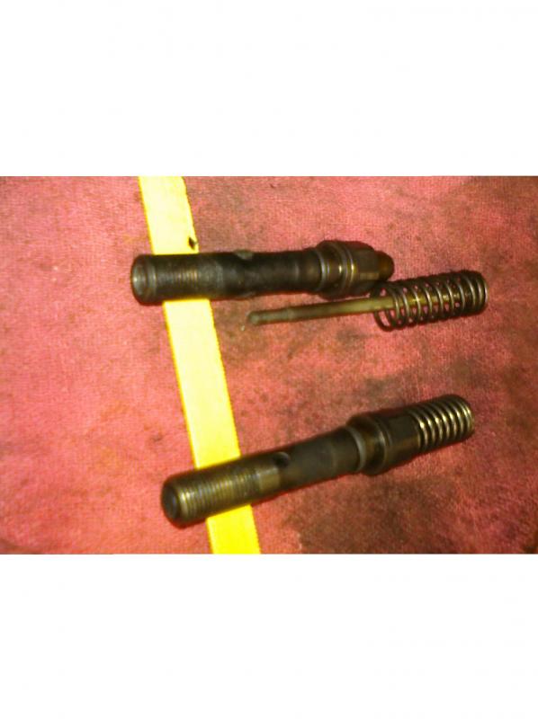

    Time to pull the cover and get rid of the jet valves.
    01-28-2012
    21
    Martinsville, VA
    I pulled the valve cover this evening, & right away noticed cylinder #2 jet valve was stuck. When I took it out, the tip end was missing, leaving it open. I welded the open end shut and reinstalled. I also removed the jet valve adjusters from the rocker arms, so now the jet valves will remain closed at all times. I think I’ll order the “JVE” kit and replace the jet valves.
    That did solve my problem….no more blow-back from that port. I’ll have to test drive it tomorrow.
