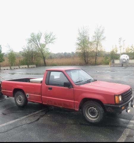

    Hey guys I just got a Dodge ram D-50 looking for some ideas ok restoring it. Itís factory red and she has normal rot on bed doors and bumper. I have a brand new black bumper but would like to restore as I call her the red rocket. Should I keep my bench seat? Change over to bucket seats? Should I kept her red or maybe go black. Tranny and engine rebuilt and she runs like a dream now itís more Cosmetic any ideas I greatly appreciate

    A seat swap is worth while. If you are only likely to ever need to carry one passenger then a pair of decent buckets are the way to go. They were an option so finding a pair will save you headaches in mounting them but even adding seats from some other car/truck is relatively easy. Everything else - hey, its YOUR truck so go as crazy as you want! Roll over bar in the tray, spotlights, bash bar... whatever is your gig.
    A list of mods I'd consider once you have your seat dilemma sorted:
    - headlights. Convert them over to semi sealed H4's with halogen or LED inserts. The factory headlights aren't awesome.
    - cooling. Delete the water pump driven cooling fan for an electric thermofan. These trucks suffer from heat soak and anything you can do to preserve your engine and maintain constant engine temperatures will prolong the life of your truck. Lots of positives to the mod besides keeping the engine at a near optimal temperature.
    -charging system. A bigger output alternator and battery is handy. Your buddies will be leaning on you for a jump start long before you will need one yourself. Any electrical accessories will be offset by having some extra juice in the system.
    You haven't stated if your truck is 2WD or 4x4 so some mods will be dictated by your drivetrain.
