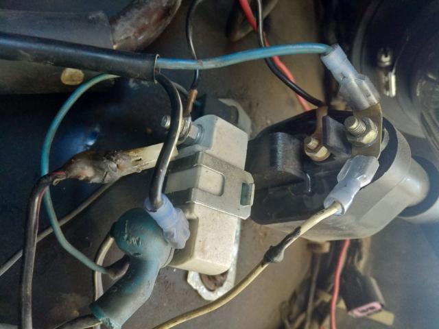

    Anyone have a picture or diagram how that eBay coil is supposed to get wired up? I'm a visual kind of guy...
  6. #31
    486
    Here's a pic of mine, note I disassembled the mounting bracket and reassembled it with the resistor block on the other side of the coil, as that made for easier wire routing:

    Thanks for the pic, that's super helpful!!!!
