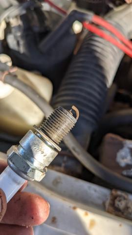

    So... I need a second guess... I'll try to keep this short. Mine is a D50 89' 4x4 with the G54B. I bought it 2 months ago knowing the head gasket was blown and had to be replaced. I've not removed the head yet but I ordered a small bore camera to look inside the cylinders. I think not only the head is gone but also the block looks toasted but I'm not a pro so could you guys give me your opinion?
    These are the links for the videos I took, sorry for the quality, the steadiness and my face. I was trying the get an overview of the cylinders but it was not easy. Also a picture of the sparkplug if it can help in any case.
