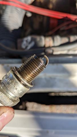

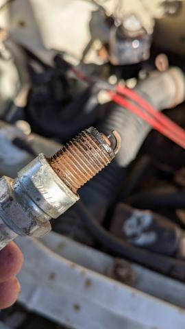

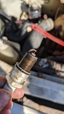

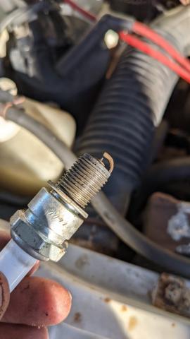

    So... I need a second guess... I'll try to keep this short. Mine is a D50 89' 4x4 with the G54B. I bought it 2 months ago knowing the head gasket was blown and had to be replaced. I've not removed the head yet but I ordered a small bore camera to look inside the cylinders. I think not only the head is gone but also the block looks toasted but I'm not a pro so could you guys give me your opinion?
    These are the links for the videos I took, sorry for the quality, the steadiness and my face. I was trying the get an overview of the cylinders but it was not easy. Also a picture of the sparkplug if it can help in any case.

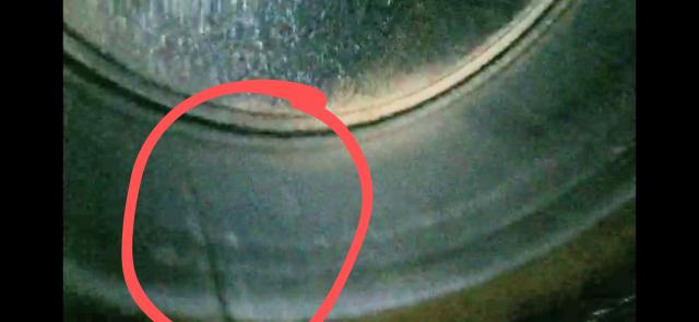

    Cylinder #1 & 4 looks OK but if you look closely there something that look like a crack on the #1. Would it be possible the block be cracked between two chambers considering what you see on all the videos...!?
    Cylinder #2 is the worst, look like there is metal bits in there, parts disintegrated from the head?
    Cylinder #3 looks better than the second but there black spots on the walls, from overheating?
    Most of the walls have vertical mark which I think is a pretty bad sign...

    Have you check the compression of each cylinder? That's the first step when internal problems are suspected. A low reading will point to the cylinder or cylinders that likely have a problem and suggest where to look when you remove the head and the blown gasket. I couldn't see much in the video, but with the head off it will be easy to assess the block's condition and then judge if there's damage or if what the scope showed was mostly just wear and tear. I bet the block will be in better shape than you fear. However, expect to replace the head. They crack easily, especially those with jet-valves.

    Biggest worry with 4G54 blocks are cracks in the top deck of the block around the head bolt holes. I've commented a number of times that a healthy 4G54 bottom end will be good for 600 hp - a healthy bottom end. High mileage or poorly maintained engines will have their lifespan drastically affected. The weak links in the block are balance shaft bearings. These things are exposed to way more rpms than the crank and rods and when they fail, it causes a domino effect of oil pressure loss. They are noisy (they make a weird rumbling noise and vibration but your engine will be dead by the time you hear or sense that) The balance shafts can be deleted from the 4G54 but it takes some effort and thought (rotating shaft bearings to block oil passages to maintain oil pressure, modified timing chains, modified oil pump shaft...) Pros - improved throttle response, weak link removed from oiling system. Cons - change in harmonic vibration at certain rpms (it would pay to weight match every rod and piston assembly to reduce harmonics)
    From your videos - some light scoring on the bore walls isn't a deal breaker but without removing the head, it's just guessing how deep the scoring is. The footage of #2 cylinder is concerning. You are right - it looks like chunks of debris have been bouncing around the combustion chamber and ripping up the upper section of the cylinder wall (it does look like fragments sitting on the piston) No obvious signs of the crown of the piston breaking apart so what the source of the debris is...? There appears to be quite visible uneven clearances between the piston tops and cylinder walls which indicates high wear.
    *don't know what to make of the 'cracks' in #1 video. They appear to be below the head gasket so I doubt these are a source of coolant loss etc

    Thanks Geezer. The gap between pistons and walls is pretty concerning. I just realized I switched videos of cylinders #1 and #4 on YouTube. You can the the crack I was talking about on video #4. Here is a picture : Screenshot_20210920-120717~3.jpg

    Yeah that doesn't look good either way. If that is a gouge in the bore, it's a serious one. If it is a crack, you're looking for another engine... At this juncture the only option you have is to pull the engine and take it apart. You may get lucky and it's all cosmetic damage (this will still require sending the block through a machine shop and ordering a stack of new parts to reassemble it) I would start hunting down a replacement engine to be honest. One that is still in good running condition. Do a couple of tests on it like leakdown and compression, buy a new water pump and timing chain kit, replace a few seals etc before installing it so you know you won't need to touch it for a while.
