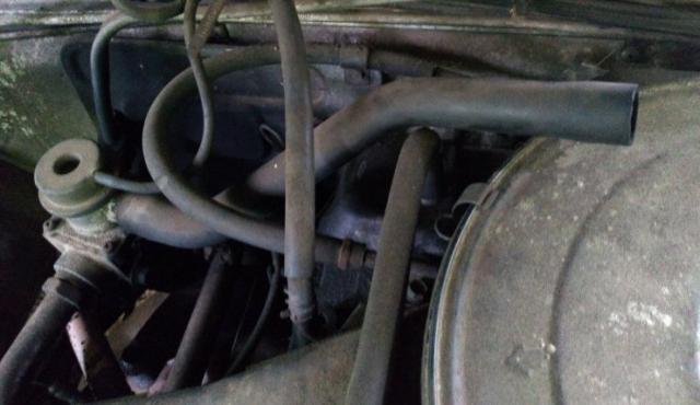

    Found this broken hose
    I haven't been able to check out the carburetor or the vacuum hoses yet but noticed a broken hose when I was checking the fluids yesterday. It's the large one that runs from the air cleaner to the secondary air control valve. Could this have anything to do with the hesitation issue?
    That hose is just another emissions recirculation pipe. No vacuum in it and it feeds into the air cleaner and not the manifold so no affect on carb operation.
