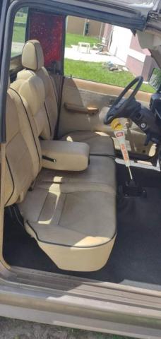

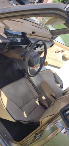

    Seen another feller on here who did this so I kinda stole the idea.
    2013 Land Rover back bench seat (cup holders)
    Yes, it fits. Fits perfectly.

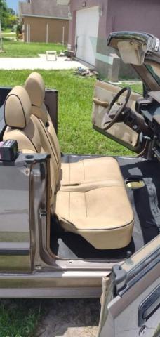

    Found the best looking one I could find at the wreckers an turned out to match my interior pretty well. Got lucky haha

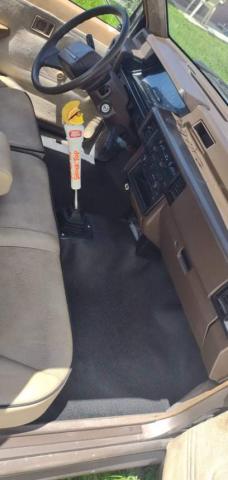

    No welding, cut the feet off stock bench. Drilled holes in Rover seat, threaded em. Bolted to Rover seat. Had to drill and thread new holes in the floor for the back feet of the bench.

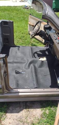

    Ripped old carpet out, smelt a combination of musty hippies and wet dog. Managed to find a company that makes vinal prints of the floor for the Max's and 50s, not perfect..lots of cut to fit but can't complain to much.
    Days work and some choices words, turned out pretty good.

    It is amazing how close the bench fits from side to side in the cab. This looks like it might become a thing as long as you can live with the void where the wheel arch would normally be. One thing that trucks don't have to worry about is the cab folding up from taking the roof off. This looks like a fun cruiser

    The bench still has the ability to fold forward also, enough room for a scissor jack and some tools.
    I haven't came up with a solid plan for the awkward wheel well voids yet. Was thinking maybe speakers? In a very custom box..

    Hmm, speaker enclosures... should be able to fit at least a 5.25" driver in there. The trick will be being able to mount it to something securely. Maybe small storage boxes as an alternative?

    Yea the storage idea has been thrown around a bit.
    Think I'm gonna try and shoot for speakers an if all else fails they'll be storage compartments.

    Honestly a bit upset with how the vinal floor came out. Wasnt the best mold of the floor pan. Lots of cutting and fitting and heating with a heat gun.
    Good enough for who it's for what I always say
    Yeah it seems too much to ask to find a supplier that can actually make carpet or vinyl fit correctly. I think vinyl is harder to deal with than carpet as it's less forgiving to pull into shape and any little mistakes trimming it can't be hidden easily. Anyone that complains that it isn't 'perfect' has never done it. My hat off to you for giving it a shot though. It looks really good
    02-25-2020
    40
    Cape Coral Florida
    Carpet is MUCH easier to work with! The vinal was a nightmare, especially in the SWFL sun. Only spot that I trimmed poorly was around the shifter hole. Cut a bit big but managed to hide it some what. Never worked with vinal before lol tbh probably the last time I do

    The vinyl flooring in my truck is not perfect either ~ another guy did it not me ~ its pretty thick stuff maybe 3/32" ?

    Yea that's about how thick mine is as well. honestly wasn't to impressed with the mold quality, Florida sun heated it up and it lost all it's form. Had to use the wife's hair dryer once I had it laid out on the floor to get some of the molding back haha.
