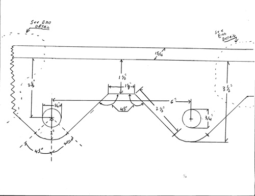

    Here is a shock mount design you can use over 1.50" round tubing. It is drawn as a duel shock mount but if you want a single mount you can just cut it in half.
    You need to use 1/4" plate steel. 3/4". DOM tubing goes in the 3/4" holes. 3/4" OD 1/2" ID 0.125 wall. That is centered with the shock and spacers spacers and welded after you have finished the main welding. This way you can adjust for tweakage.
    NOTE: If you are using 1.50 spacers then drill the holes for 1/2" not the 3/4" that is on the drawing. You may want to consider adding some holes to the top to allow for more welding surface.
    NOTE: Some shops do not have a die that will allow them to bend such a deep Chanel.
    The PDF has more detail.
    CLICK HERE to Download the .PDF

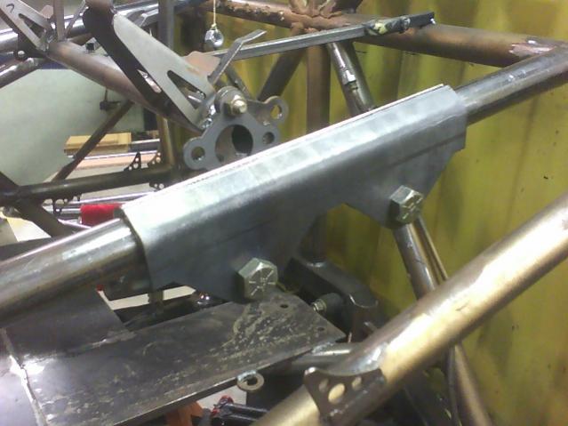

    Final Shock Mount
    Here is the final product from the drawings. You can also use 1.50" spacers if you want to. I changed the design just slightly to accommodate them. You would need to make the bolt holes 1/2" not 3/4".
    Since it was just too tight for the press break they need to be built in half sections then welded together. I used 3/4" bolts to hold the spacing where I wanted it for welding.
    Total cost including laser cut $200.00 for the set. You can have it done locally with the drawings supplied.
