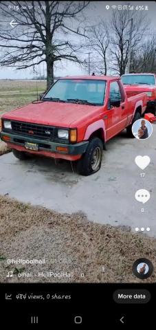

    Done research off this forum for years. I've had this little trick for about 10 years. Recently started reviving it. Will sgart threads about my headaches and look forward to the advice I receive from others with experience. If you're curious about what I've done so far, my tiktok name is the same as my name here

    Nice truck. The V6's are hard to come. Post some pics!
