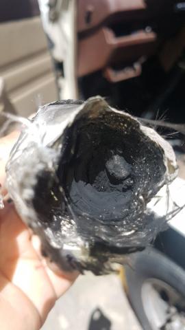

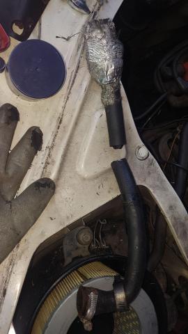

    Another question: my reed valve on the secondary air system is dead - so is the pipe from the air filter
    As you can see there was a repair with tape from the previous owner but the pipe was fully obturated :
    I plan to eliminate the reed valve (with the plug on the pipe from the extractor) and plugging also the exit from the air filter box. Do I miss something and should I intervene elsewhere?
    Thanks!

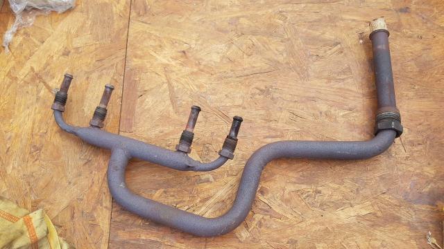

    As stated above, I wanted to remove the secondary air system on the exhaust header:
    If that can help other, the thread is M16x150 and a standard oil plug can do the job:
    Here is how it looks:
    Yeesh, the gas scavenging in European spec Mitsubishis is awful. Headers for L300's are available and will yield good improvements in torque. Added bonus is eliminating the EGR junk. A Weber carb will benefit having a set of headers as part of the upgrade. Adapting the air intake for a Weber can be achieved by using the carb hat from a Rover that came equipped with the 32/36 (you should have more luck sourcing one in the EU). Don't use an open air filter on the Weber as it will cost you torque.

    those little exhaust port tubes....
    i just cut the tube about 3/4 inch from the fitting, hammer the tube ends flat then screw them back in

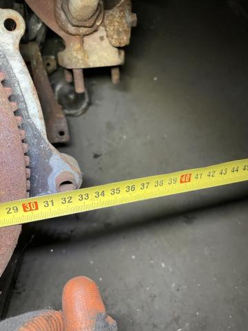

    I received the metric measurements from the seller. I post them here as they maybe helpful for others too:
    Removing the first 10/15mm at the left makes around 310 mm or the 12.5 inches that I found here and over the internet. This means that this is a narrow block (the egine comes from a 4x2 L300 so it is not surprising) and not a wide block (330mm or 13.25 inches) and because I own a 4x4 the engine won't fit.
