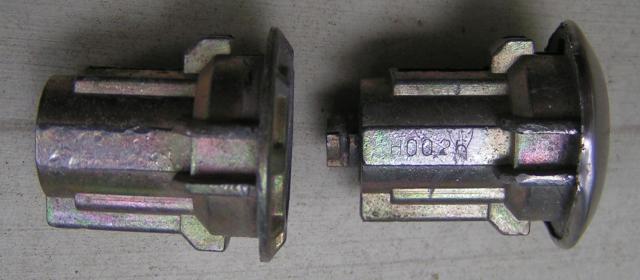

    I have a pair of lock housings I removed from a Gen 2 truck years ago. Needed some internal pieces. I didn't mark which came from which side, but one is stamped with a five-character code, H0026. The other is blank.

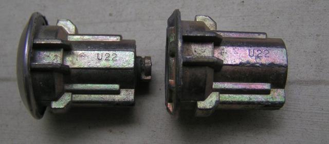

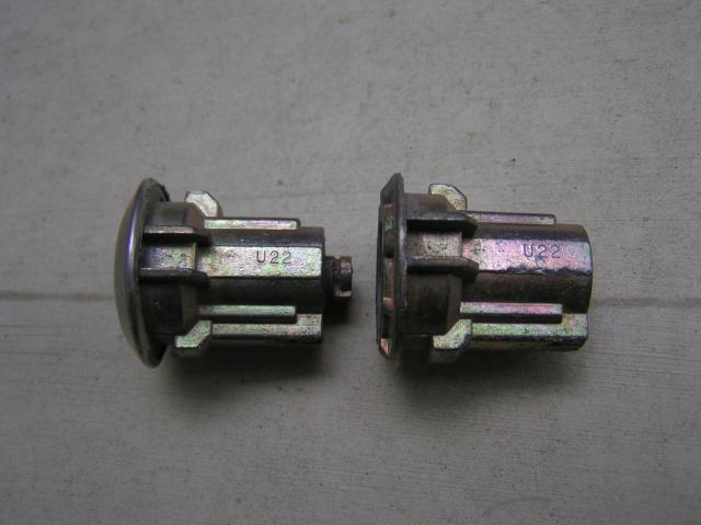

    Both housings had the same three-character code (U22) on one side. Probably to indicate they're a matched pair.

    The H2489 is the code for YOUR key, if you go to a locksmith, they can look it up (will charge for lookup) and cut it from the saved keycode. As you mentioned, this code is stamped on OE keys

    you are correct! the key code is on the passenger door lock, it is a 5 digit code starting with a letter and 4 numbers. I too am looking for the curtis industries code book.
