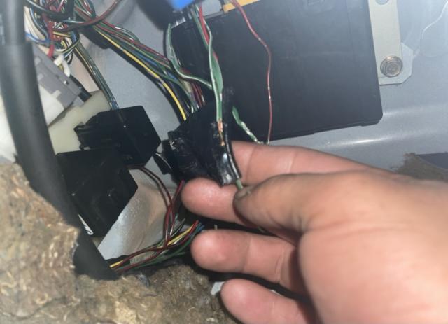

    Bought a new dash illumination switch, when it came, I realized the one in my Max is literally connected to itself. Makes sense because when I got the truck the knob didn't do anything for the dash. The dash lighting and the taillights worked for one day and stopped.
    Directly next to the dash knob there's two cables connected to each other, a blank and a black oranges, they look to be for the dtrl/turn signal/wiper switch.
    First question is are these supposed to be connected to each other? They have the same male female crimp connectors as the dash knob switch and they're literally right next to each other. Looking at the wiring diagrams I can't make sense or not make sense of it, help on that would be appreciated.
    The taillight/license plate lighting cables come up into the cab under the passenger seat and go across the floor and come out up in the corner to the left of the brake pedal.
    There are two splits on the green white cable that look like they may be factory but I'm honestly just not sure. Pictures attached of those splices. One of the green white wires was cooked and was connected to other cables after following it from behind the fuse box to where the taillight wires fish out from behind the brake pedal.
    My question is if somebody can confirm these are correct or incorrect? They did have crimps on them but one of the cables was decimated and that the dash knob wasn't connected to anything is making me question it was right.
    There are three relays on the driver side attached to the body next to the battery, the one directly next to the battery is MD128752, after looking this relay up all I can find is that it is a "multi purpose relay", can anybody please let me know what relay this is for? It seems to be connected to the wiring that is used for the headlights but it's wrapped in so much tape thought it might be easier for somebody to just tell me if I even have to worry about that relay.
    There are two other relays between the battery and the cab which also seem to be coming through on the same tape rope coming through the firewall, both of these relays are labeled "056700-4810", thereo cheap on Amazon, just wondering if somebody could also let me know what these relays control.
    Just want my taillights to work, don't care if the dash lighting to come on but if my taillights worked I could at least cruise at night haha. Thank you.
    The big relay next to the battery 'should' be the ignition bypass relay. It cuts power to accessories and lights when you crank the engine over to prevent an electrical system overload. It has a 6 wire socket plugged into it. Your wiring pics are a worry. Some look like they've either been crushed or melted from a short. Mitsubishi used little crimped metal sleeves to branch wiring off the same circuits and wrapped them in electrical tape. You'll find them all over the place (mostly main ignition power feeds and lighting circuits)

    The wire that was cooked was melted into other wires, very little and sporadically but still, you think I should also recable those lines or just electrical tape around the parts that got melted together because of the short and call it a day? Feel like it's a dumb question but still. Thanks again.
    I'd cut and strip the damaged area, slide some heat shrink tube over the long end, solder the wire back and shrink it up. If the wire itself has been damaged, you run a risk of it eventually failing if you don't ensure a good connection.
