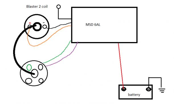

    well ive tryed so many variations from all kinds of sources and i think it all boils down to having a 3 wire dist vs a 2 wire msd ignition, and yes accroding to the manual i cut the correct wire from the back of the msd ign box. ill try to draw a post a diagram asap

    msd.jpgthe msd ign is pn 6420
    Make us a wiring diagram of how you have it done along with the MSD part number and page you are using. It will help. You did clip the correct color wires in the ignition unit correct? The more info the better. OH ya use the search for MSD I think we had this problem on another truck.

    it looks slightly different from what i got, but im getting the sense that this info is more specific towards my app

    The thread that Camoit posted should help you out. A few things to add: No other wires should be attached to the coil with this ignition, ONLY the ignition box black and orange. Your dizzy should have a green and a black with white stripe wire coming out of it. The green wire will connect to the white signal wire on the ignition box, the black to the red wire on the ignition box AND to your ignition switch (12v source).
    Post #9 in that thread has the schematic. The new digital 6AL box has a green wire for tach signal, only difference.
