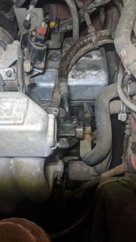

Posting from Hwy 14 in New Iberia, La. I have a 1991 base model that started losing power. When I stopped, I smelled gas and saw a leak. I took a picture of it. Any suggestions? Thanks! Ok, never mind. The damned file will not upload. It is where the fuel line connects with two screws to the carb on the top driver's side of the engine.

I just got this 1991 Mitsubishi Mighty Max base model, 2.4 L, so excuse my ignorance. I lost power and managed to get the truck off the street, but it was missing and clunking the whole way. The high pressure fuel line, where it meets the fuel rail, was leaking. There was a strong smell of gas, and I could see the gas pooled in the tops of the two screws that hold the line to the rail.

I will try again to upload the photo I shot of the situation. It wouldn't let me upload it from my phone earlier (when I still thought I had a carburetor).
