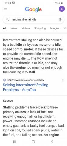

  2. #27
    1,581
    LAZY ME not having read through all the posting on this thread is wondering if your truck uses mech or elec fuel pump..? What causes an engine to die (besides all those complicated electronics icm fuel injectors maf TPS etc???)
    1) Loss of spark
    2) No fuel or fuel problems
    3) Failed alternator
    SERVICE ORDER
    1) Load test battery
    2) Test fuel pump pressure
    3) Test alternator
    Test drive & report any further problems to customer esp if reported problems cannot be duplicated ~ probable replacement of ICM is required if unable to diagnose causes of customer complaints...
    Parts: $577.00
    Labor: $1,349.00
    FACTORY ICM: $721.00
    TAX: $98.00
    TOTAL $2,745.00
    <---- you'll fix it soon
