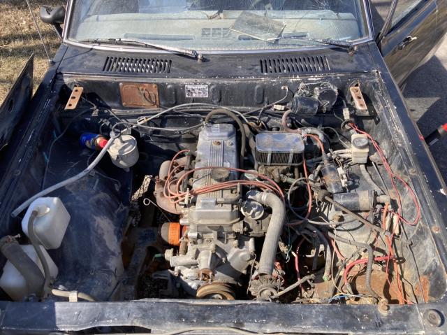

    Okay so I’ve read through about every thread I could think of on here without registering to see if I could dig something up and haven’t been able too; considering the knowledgeable people here we are I registered, I’ve got a 79 dodge D50 atleast that’s what I’ve been told through the courts, while on the other hand I’ve got a paper from the original owner stating it’s a first series Japanese import, Mitsubishi triton????; whatever the case being with that I’m new to these things and I’m looking to get it running. That being said I’ve got no clue where to start, the transmission is currently sitting in the bed as we took it out and rebuilt it; (KM132) the motor is ~there aside from the radiator that was pulled while it sat in the guys yard (G54B) i have no clue what to do whether it be the wiring or the radiator and I’ve never touched or even seen one of these motors, here’s a ton of pictures and if anyone’s looking to help a new guy out, it would be unfathomably appreciated. :)

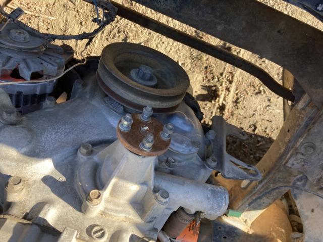

    The truck is straight other than what I can tell is going on with the motor missing the radiator (he cooked a bird and it blew a hole in the radiator and it’s sat since, his son ditched the radiator in plans for a rebuild and never finished it) and what I think to be possibly a water pump.. I’ve got a clean title and it’s a 2 owner truck me being owner 2, I’ve got ~above average mechanics knowledge as comes with taking the trans apart and rebuilding it but my problem is knowing quite literally ~squat about Mitsubishi or this motor in general, I’ve looked at an engine diagram and tried to piece it together but for some reason it’s like reading brail. I’m gonna drop probably 20-30 pics into this thread when it clears up tomorrow (currently pouring rain and I’ve only got a few photos of the bay because that’s been my focus) IM SORRY IF IM TERRIBLE AT THIS USUALLY I WORK ON L200s! That’s where my little knowledge of the KM transmission comes into play, other than that I’m basically a baby with this motor, if I can figure it out I’ll source a rebuilt motor.
    These trucks were sold under a number of different names globally. Japanese market was the 'Forte', L200/L200 Express, Triton (but this name was used for second generation trucks) The Astron engine is like most chain driven engines except for the twin balance shaft layout running off a second timing chain. It was good enough for Porsche to copy it. The wiring is basic - not much to it. First gen trucks have an all metal brass/copper radiator. They share the same radiator as the Mitsubishi Express vans built in the same era except there are no side mounts soldered to the radiator frame (if you find a bad truck radiator but a good van one, a shop can solder the side mounts to it and make it serviceable which is what I had to do) There are alloy reproduction radiators that come up from time to time on ebay. Gen 2 trucks and van radiators won't fit. It looks like the PO has changed the carb on it. Have a good look to see if it's a Weber. If it is a Weber, you're off to a good start. The factory Mikuni carb is a pain to work on and nerfs engine performance.

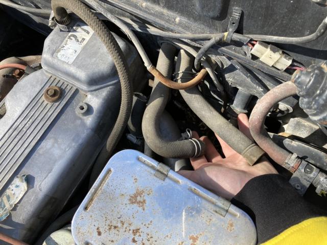

    *going off the images the heater hoses have been disconnected. One goes into the intake manifold via a hose barb from the top. It'll have the main heater hose barb and a smaller outlet branching out of it for the water choke which will be redundant if you're using a Weber carb. The other heater hose is hooked up to a bypass pipe that runs around the rear of the engine. The ends of these bypass pipes are notorious for rotting out.

    It is a Weber carb, it was replaced shortly before the bird was smoked and he quit driving it lol. My big loss here is the wiring, I’ve sourced a radiator that will fit, the transmission is primed and ready to be bolted up once I know this block cranks and isnt done for (it’s got 12,000 original miles and doesn’t have the orange roll over tick suggesting it’s more than that) if you look at the picture of the whole bay, you can see that there’s 2 distributors, ones hooked up and works and the other is bolted to the inside (guessing it’s the original) but still wired in somewhere, the old man was really nice but it seems like he tried to fix what he could on this car himself and turned it into a hack job with the wiring, I’m almost ready to buy a knew wiring harness and take the 4+ hours to rewire everything but I’m hesitant as they’re expensive and I’m already in $1400 on what was supposed to be and beater with a heater. Guess I fell more in love with it than I thought lol.
