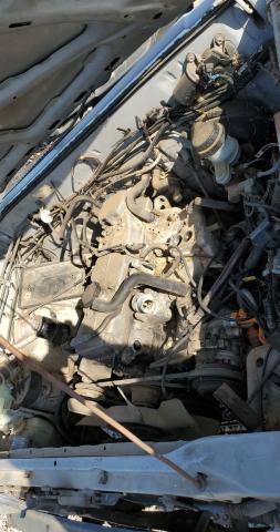

    I was given a 1979 or 1980 Dodge D50 Sport with a G54B Engine in it. The truck is automatic but my neighbor who gave it to me, stated his daughter ran it low on oil and a rod ended blasting through the oil pan. I dont think its rebuildable or how much damage was done. I'm assuming the engine is done for.
    I've been trying to find a replacement engine in my local junk yards for about 3 years now and no luck.
    I found a truck that has a G54B engine, 6.5 hours away from me in a junk yard and I'm willing to go pull it, but as I was doing research to determine whether the engines were compatible, I read that there is a narrow block and wide block g54b.
    My truck is an automatic, the would be donor truck is a 1988 dodge ram 50 sport standard.
    Would this engine be a good direct fit replacement? or do I need to keep looking? I really want to get this truck going.
    Any help is appreciated, thanks in advance.
    I attached pictures in case it helps.
    this is the junkyard engine
    This ones mine...

    Good that you posted pix.
    As I remember, the automatic 2.0 block is a "Wide" block, and the 2.6 at the junkyard is also a "Wide" block.
    There are a few differences between the 2.6 and your engine, but the JY engine should bolt in.
    I would PM Geezer, StarionGuy or Xboxrox (forum members) to verify. They may see this and add information. They are pretty active here and know their stuff.
    A along time ago I had Mighty Max 2.0 automatic and had a PIA dealing with the Wide and Narrow block issue.

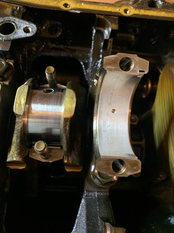

    Ok, so I finally got around to pulling some thing off the engine. I didn't find or see anything in the oil pan. I removed 2 rod bearings and a main and saw some haziness on them. One looks like it has score marks from maybe a piece of metal getting caught between bearing and crank. (I'll post pictures below).
    I didn't see any sludge buildup anywhere inside just dirty oil.
    Unfortunately the speedo was gone when the engine was taken out so I couldn't tell how many miles it had.
    I have removed the timing cover but have not removed the head yet. Any recommendations on where I should get a timing chain kit and gasket set for the engine?
    This is the first Rod bearing I pulled off
    Here's the second
    Here one of the mains
    I'm not too familiar with internals of an engine but I know the basics, so I was hoping you can tell me how bad these bearings are?

    I took 2 rod bearings out, 1 main bearing and noticed some "haze" and some scoring. Not too sure how bad they are.
    I didn't know where I could find gaskets for this engine, but after much searching, I have ordered a head gasket set, Timing chain kit, lower gasket set, and water pump. I know I will need a few more things but I will get those as I go. Right now the head, oil pan, timing cover and most of the old gasket material is off. Still needs a bit more cleaning.
    Since the parts are going to take a lil while to get here, I will be working on taking the engine out of the truck this weekend.
    What do you guys think about the bearings? I'm not very familiar with dealing with internals of an engine so I was hoping you could give me some advice.

    Chavez - Those rod bearings look fine. If you are worried, you can replace them at little cost. They're about $20 on eBay. The crank looks good too.
    Looks like you may have found a decent replacement engine.
