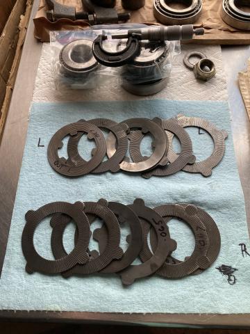

    picture repost,
    As far as 'track truck', still in the research stages...
    The clutch pack 'stack', # of discs, plates, and position
    of bellville 'springs' are different between
    Montero
    Pajero(sp?)
    Starion
    D50 (Max),
    I did not research any EVO config's.

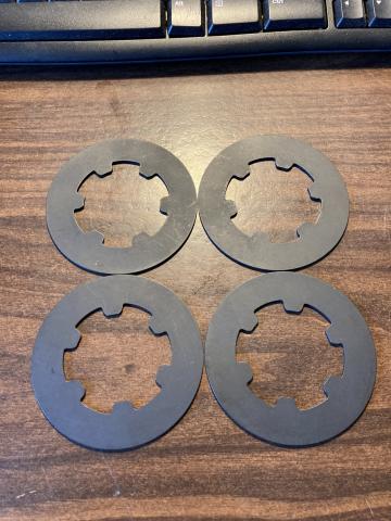

    parts!
    that covers the shim/thrust washer end of things,
    4 new friction discs on the way,
    then pics of various 'stack' configurations.

    These arrived today, time to start the shuffle ...
