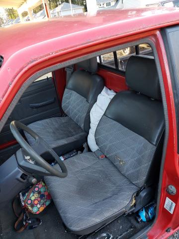

    Just saw a post confirming that seats like this from a '85-93 Mazda B-series are a direct bolt-in swap:
    In fact, those vinyl shoulders remind me of the Montero/Raider seats, wonder if they could be from the very same supplier?
    Hmm, nice find SubG
