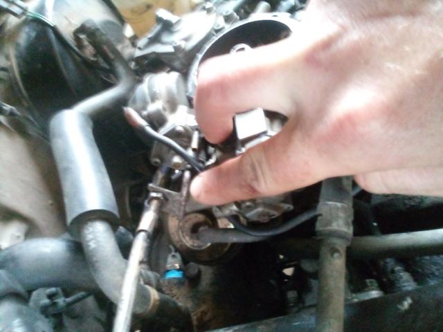

    I am trying to find out what if anything should be on these empty ports on this mikuni carb . My fingers in pics point to them.

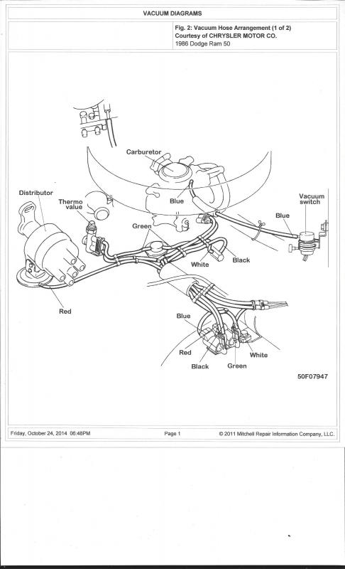

    Is there an external vacuum switch mounted to the side of the engine bay somewhere? You have the electric choked version of the Mikuni/Solex carb that is relatively uncommon. That vacuum barb on top operates the choke release assist actuator (the diaphragm has probably gone bad in it anyway...) I found a vacuum line diagram but I'm not 100% sure it's the right one for your truck. In all honesty this carb is gonna give you nightmares. Kits are available to retrofit a Weber 2 barrel downdraft carb that will simplify the layout and massively improve reliability and performance. Lots of info on site if you want to investigate it.
