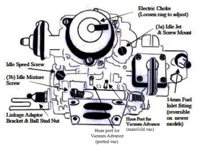

    As for "vacuum beast", I think that reputation is because one of the vac-advance barbs on the DGEV actually provides "manifold vacuum" (taking vac from below the throttle butterfly), so hooking up the ignition advance to that causes strong advance at idle, diminishing up to partial throttle where it starts to taper off more steeply. The other vac-advance barb just above that one (usually capped with a small screw on new DGEVs) provides "ported vacuum" (taking vac from just above the closed throttle butterfly), so hooking up the advance to that one only causes advance just-off idle and up to partial throttle. Originally, all vac-advance used manifold vacuum, but then as emissions regs tightened, they invented ported vacuum as a way to disable advance at idle, thereby raising combustion temps at idle to help burn hydrocarbons more thoroughly in that state.

    I'm trying to understand the vacuum advance you described. I'll have to verify if I'm taking vacuum from below or above the butterflies, if I can.

    Looking at the side of the DGEV where the choke element/linkage is mounted, there's two vac barbs. One is slightly above and to the left of the other, which is normally plugged with a small screw; I'm not certain but think this one provides ported vac, whereas the other, lower one provides manifold vac. I amended this diagram to show what I mean:

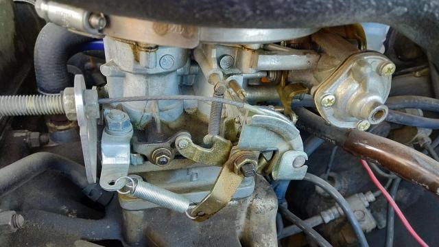

    Great news, maybe I'll give another go at flipping my DGEV around. BTW, my return spring setup:
    That's a much better return spring setup than I had in mind. Thanks for the help!

    BTW, the anchor brackets for the cable housing and spring on the left, and the curved bellcrank for the cable at the right, came with the Weber linkage kit for a Mazda pickup, Redline Weber part no. 99007.675.

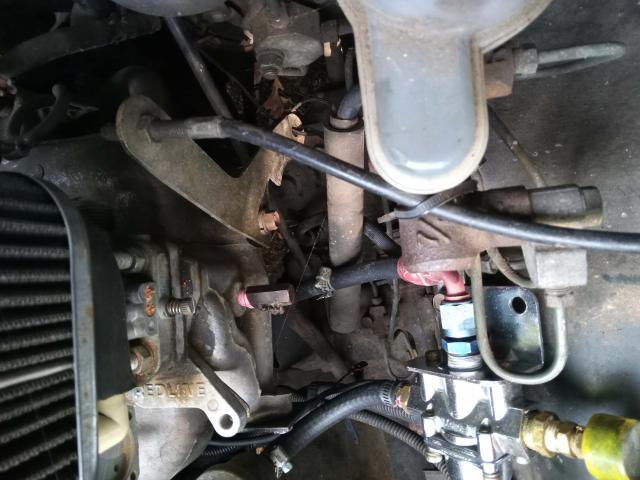

    The bracket holding threaded end of cable jacket. The gold bracket you see here in my pic came with kit years ago, still dont know what its for.

    Aha, that "boomerang" bracket in your first photo is meant to go on top of the valve cover, to anchor the cable housing there if it was coming at the carb from the exhaust side as stock. It won't be used with the cable coming from the intake side as you've got it. The linkage kit for a Mazda pickup (Redline Weber part no. 99007.675) will include the brackets and curved bellcrank I'm using:

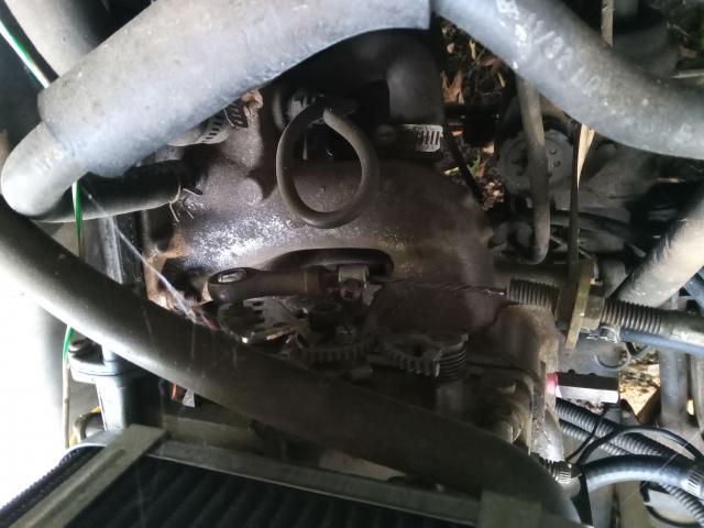

    I appreciate your help. May be ordering bracket soon, as a rebuild kit is suppose to be here tomorrow for the 38. After looking at my own pics I may put a spacer in to raise carb and rotate the crank of shaft upside down. (pulling underneath from opposite but stock direction, putting cable back in stock position over valve cover). Its going to take alot of spacing to raise carb though if possible.
    Im going to double check soon.

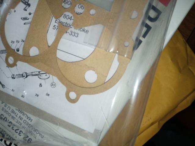

    Got the rebuild kit in. The redline weber kit, one of the gaskets look like crap. Looks like partial creases and rips on the paper mounting gasket were there from manufacturing. I guess im going to have to add some sealer incase. just sucks to spend money on authentic parts only to get generic cheap looking parts. Bought off ebay, may send back but dont really want to lose time waiting to ship back and wait for replacement. Not so much sellers fault, you can tell the factory didnt do well making it. Makes me miss the Holley 5210.
