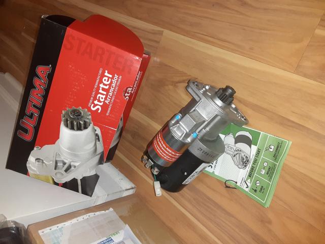

    Too bad the coned starter did not fit ~ just ordered a rebuilt starter from OReilly's delivery Aug 3rd free shipping
    Time to end this thread
    P.S. The autoparts websites say the open face starter is for automatic transmissions but NOT ON MY 5 speed manual TRUCK

    Thanks Chargerx3 checked em 'n all good ~ this is the 3rd time the starter totally failed ~ ordered a rebuilt starter from OReilly's ~ their free shipping was quickest delivery; their online part photo look exactly like our part ~ oddly the open face type starter is listed as for automatic transmission but it's what fits into the km132 (?) 5 speed manual tranny ~ whereas (on our truck at least) a coned end type starter will not seat into the bellhousing ?!?
    Maybe parts #s get typOH'd when entered..?
    Aug 3rd is expected delivery date ~ lifetime warranty keep the receipt B.S.

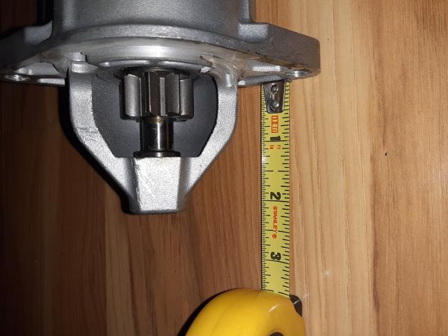

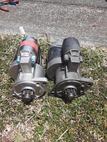

    SNOUT LENGTH of a cone end type starter would be nice to know between my farm forklift unit & a unit that fingers, finalfighter and pennyman have mentioned they (have?) fit into a manual tranny truck...
    I could/should take photo with tape measure to show the snout length of this auction unit I bought AND THEN ASK (I think it's FinalFighter?) that has a snout end starter on hand as spare part to measure his too... (?)
    I might be able to use the farm forklift solenoid (as spare part only) if it matches the one soon to be coming out of our truck... It would require soldering the white wire onto the 4th connector spot...

    MY SNOUT LENGTH izza about 2 1/16" ~ 2 1/8" long... Whats Your's..?
    IF I wooodah been thinking on my feet then the day Vernon had the old starter removed side by side with the new farm coned model we could have tried comparing solenoids & if same then reinstall the old starter equipped with the new solenoid..? Might not have had to order a rebuilt starter; ya think..?

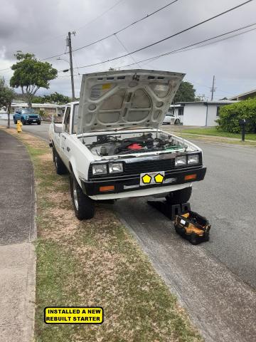

    Trying this today... IT WORKS, TRUCK STARTED OK TWICE..
