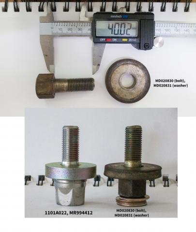

    I dont know this has been covered, but I found that the six cylinder gen 1 and gen 2 Monteros have a crankshaft bolt that works for the 2.6 engine as well. The 4 cylinder bolt has been discontinued, thus this is a great solution:
    New style crankshaft bolt and washer for the six cylinder and works for the four cylinder:
    1101A022
    MR994412
    Old crankshaft bolt and washer (discontinued)
    MD020830 (bolt),
    MD020831 (washer)
    Here is a comparison photo for reference:
