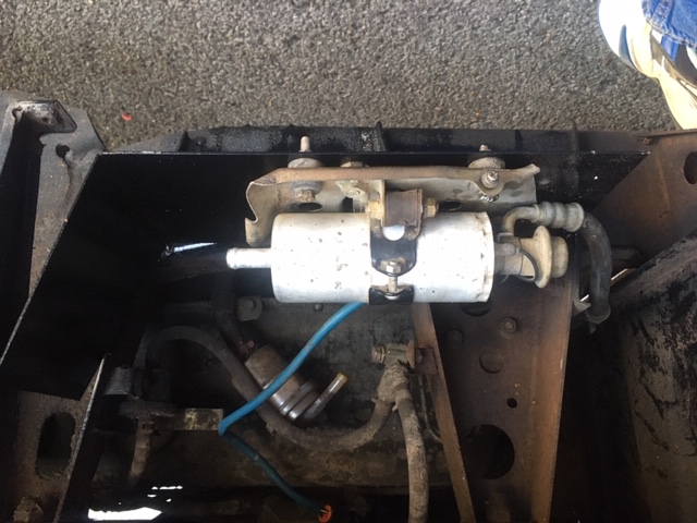

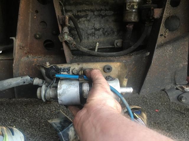

    Fuel Pumps for Fuel Injection/Turbo
    Fuel Pump Time!
    You gonna need a high pressure pump. I chose to use the stock Starion pump in keeping with the theme of " make it with what ya got and use stock parts whenever possible. Here, Ive got the stock pump and bracket from the donor, with the funny curved bracket
    This bracket is great, it has two sets of rubber mounts, this helps keep the pump from vibrating against the body and making noise, but the dogleg is in the way so it has to go
    Cut away the crap and I've figured where I want it, under the side cover right by the tank, fuel pumps work better as pushers so low and close is the game, you might be tempted to mount the pump like this on the outside of the frame and be done with it
    BAD, NO! the pump has no protection from rocks kicked up from the tire, and it's hanging off the rubber mounts that weren't designed to do that, they work under compression. It has to be mounted flat and up. So I get out the CAD (Cardboard Aided Drafting) tools and made this.
    That'll do it. room to run the lines, a little kickup in the front to prevent rocks and it's still easy to get at, just take the panel off and voila!
    Here is the cardboard bit/metal cut out prior to bending. you can bend this in a brake or you can bend this in a vice or you can do as I did and lightly score it with the angle grinder before whacking the bejezzus out of it over a 350 block lying in the yard to get a crease.
    You can weld it (like me) or just sheet metal screw it to the frame rail. Don't try to through-bolt it however, the frame will just collapse without internal support.
    Next you have to get some 5/16 steel line and bend it to fit the frame/flare it to mate with the 5/16 fuel outlet fitting on the pump. Do yourself a favor and buy or rent or borrow a flaring tool like this one
    DO NOT try to flare steel lines without a tool like this, it's just frustrating and you will get leaks if you try to use a tool like below
    Trust me, this tool is crap, use the lever style one.

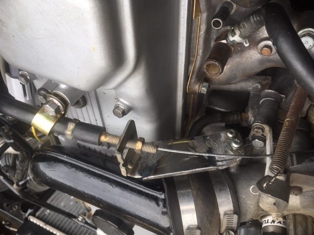

    Throttle cables
    The Starquest uses a cable very close to the D50. Here they are side by side, gotta use the Starion one as you no longer have a way to adjust the D50 cable.
    The screw end on the left is the original d50 part, the two bolt flange on the right is the Starquest.
    You can use the Starquest cable on the d50. It takes a bit of light cutting though.
    You must cut the original flange off the firewall to make it flush. I used a step drill bit until the outer barrel fell away. Then add two screw holes to the firewall for the flange of the Starquest cable. Point it slightly up as needed to loop back around over the valve cover.
    Then the next part is the length. the cable. If connected to a stock d50 throttle pedal, is too long. but do not despair, you just need to extend the bracket with a bit of steel and a welder.
    diss too long must fix.
    extend the bracket by like 2.5 inches with trusty welder. , note the angle change, it's to fit the hood.
    now it all works.
    and that's how to adapt the cable to fit the d50
