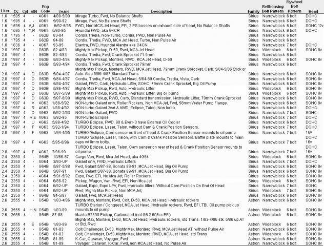

    Since you have a 2.0 you will have a narrow block engine/transmission, which limits what you can get a donor transmission out of. If you can find a later model year truck with the 2.0L engine in it then you should be good to go. The 2.6 and 2.4 were both wide block motors, so they would not work. The same would apply to other rear wheel drive Mitsubishi vehicles. If you could find a Montero with the same engine or something along those lines you'd be good to go there as well
    *just to clarify - the G63B belt drive engine is the successor to the 4G52 (both are 2.0's) Looks like a 4G64, but carb'd. A G63B truck is the one you're after (transmission designated as a KM132 - the KM145 is the wide block 5 speed variant)

    One thing I noticed - I also had an 89 2.0 automatic which needed an engine. The blocks between the auto and 5 speed had totally different bell housing bolt patterns. The auto block bell was much larger, although everything else was the same.
    I bought a standard shift replacement engine and discovered this. WTF

    Autos on trucks are all wide block. This is the only anomaly to 'the rule'. It would probably be cheaper to ship your trans from NY than to go through the effort of finding one in a JY in CA (if it's already sitting in storage and not in a truck...) Wait til you have to get a starter motor - it can turn into headache material pretty quickly if you aren't aware of the different starter/engine and trans combos.

    I did find a later KM132 in a yard near Seattle, Washington. Even better, the engine was already out and all I had to do was remove the trans mount bolts and shifter. It dropped out. Way too easy.
    I also took a 13 month (!) guarantee on it - just in case.
